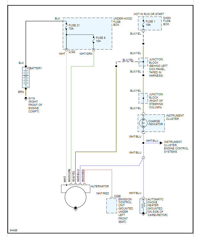

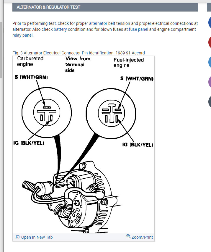

i bought this car someone cut the plug from alt. i cant get it to charge how do the wires go back together.
Jan 11, 2009 at 2:57 AM
Experienced Mechanic
18,907 POSTS
You are going to have to replace the connector and then test the system to make sure it is operating. Here is a guide that will help with this test:
Below you will find the wiring diagram and info on the pinout chart.
Please run through this and let us know if you have other questions. Thanks
