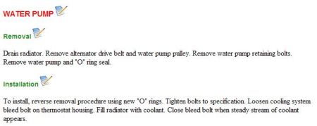

Need to know what needs to be removed to remove this water pump and any tips.
