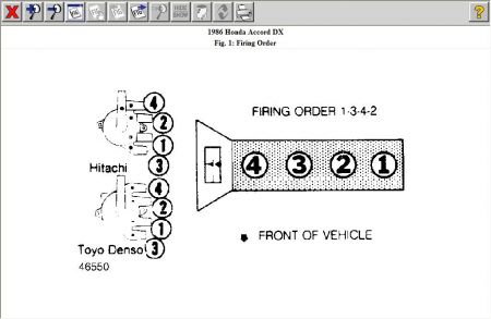

1986 Honda Accord Spark Plug Configurations
222,000 MILES • 4 CYL • 2WD • MANUAL
JKELLY013
I'm an idiot and didn't mark the wire patters of my wires before I pulled them to replace the plugs and was wondering if there was a chance you guys may be able to get them to me. Thanks.

See below
https://images.2carpros.com/forum/automotive_pictures/12900_fo_7.jpg
