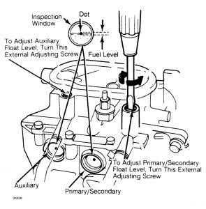

i rebuilt the carb, and now it wont idle. it will start to idle but then it will all of a suden just drop in rpm's and die. i can keep it going by pumping the gas pedel, and putting it in nutral. i have gone to the salvage yard and replaced the idle seliniods and the idle vacume. but i dont know what i need to do to fix the problem. please help i dont have the money to get a mechanic.

Did you check fuel pump pressure before you rebuild the carb and also the float level? Also could be coming from the emission control unit-Try readjusting the idle speed screw and check ignition timing-

do u have enogh fuel in the carb check float level
