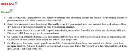

How do I replace a Rack & Pinion from my 1985 honda accord?
Jul 26, 2010 at 1:27 PM
BLUELIGHTNIN6
Experienced Mechanic
16,542 POSTS
Jul 26, 2010 at 2:32 PM
