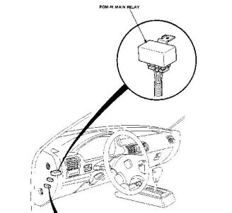

For the year model, the most common fault for intermittent non startinmg is a bad PGM-FI main relay. Replacement is not necessary, just remove it and resolder the joints, should get it working perfectly.
https://images.2carpros.com/forum/automotive_pictures/192750_PGMFIRelay90Accord_7.jpg

THERESAROE
Thank you so much, I will try this and let you know.
