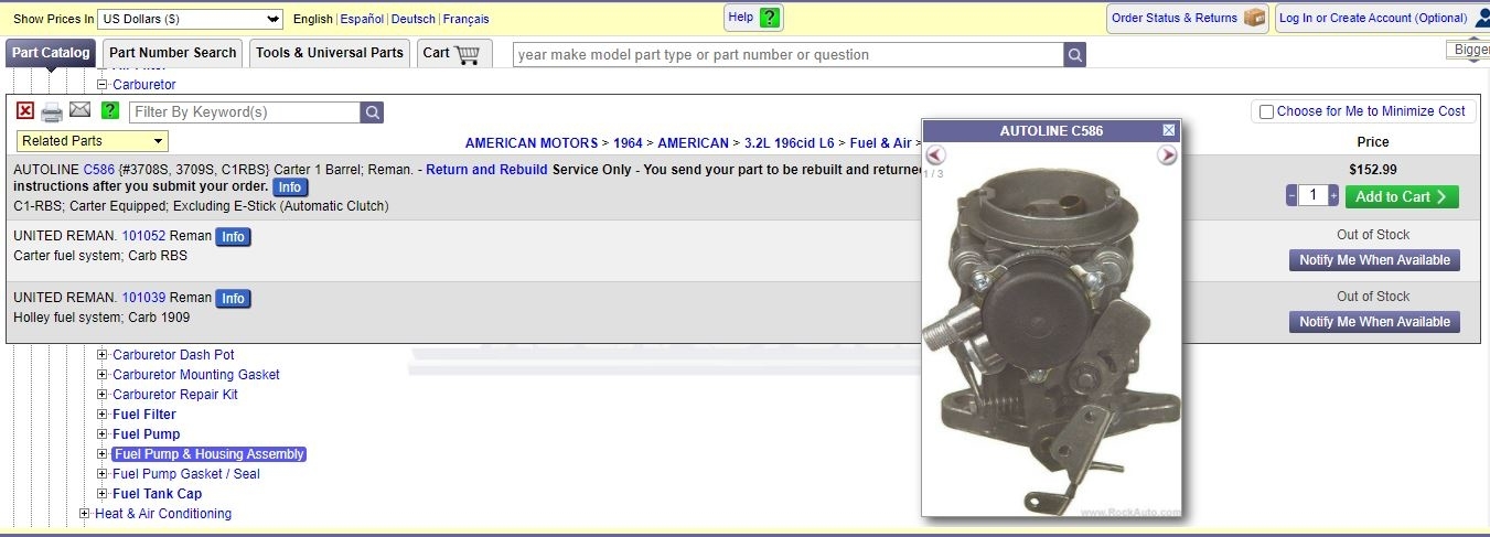

No longer available, neither new, rebuilt, or a complete rebuild kit. Is there another one barrel carburetor I can retrofit?
Mar 22, 2021 at 3:59 AM
Good afternoon,
I attached a picture for you of the carburetor. Rock Auto offers this carb but you send back your carburetor and the rebuilder repairs it for you and returns it to you.

Hi Danny.
The first thing I looked for was a carburetor kit and found one.
https://www.carburetor-parts.com/k4088.html
As far as replacing it with a different carburetor, check this out.
https://championcarburetor.com/6265-replacement-carburetor-for-holley-1909-1v-144-170-196-200brfont-colordc143cbbrand-newbrdesigned-for-modern-fuelbfont-p-10735.html
The kit will be cheaper than a different carburetor and less labor intensive to configure it, but there are choices out there.
