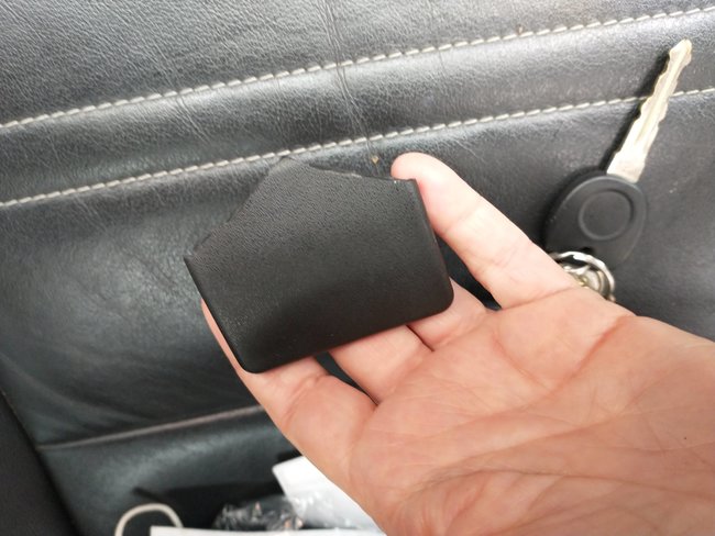

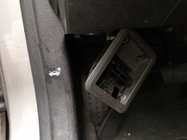

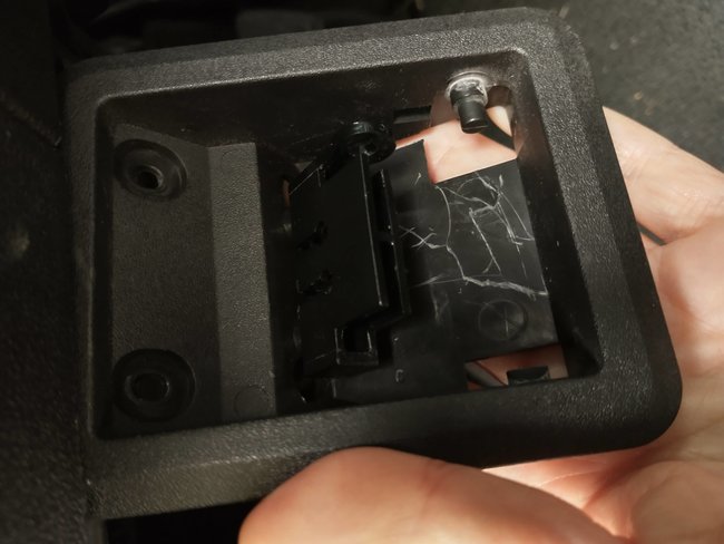

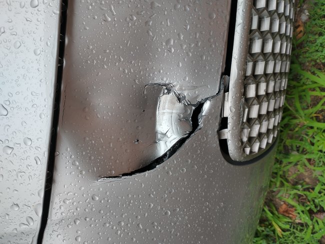

Here's what the hole in the bumper looks like. so, I'm assuming the housing hole is right behind it. But I can't open my hood because the hood release just broke off in my hand. Any idea how to get the hood open without it? I tried but can't seem to get it to work. Ugh.

Can you access the cable for the hood release? The cable is attached to the plastic piece.
You should be able to use a plier to grab the cable and pull to release the hood.

I can only get the driver's side latch to release. Is there any other "hack" besides doing all this? - (found on a forum):
See if you can grab onto the end of the cable and pull it to release one side of the hood. If you can, try to put a rag or similar over the latch to prevent the hood from relatching on that side.
Then you will need to jack up the other side of the car where the latch does not release, pull the front wheel, then the inner fender and you should be able to access the hood latch that is not releasing.
You will have to go in there and manually release the latch
Failing that, you can probably remove the four bolts that hold the latch to the hood and get it released that way.

Unfortunately, given the design of the latch and cable system it will require you to remove the tire to get to the latch as that instruction suggests. Any car with that style hood opening is little difficult to work on the latch.

Bummer. So, bottom line, from your expert "speculation", is it safe to drive long distances with a hole in the housing? I need to make an emergency trip before I can have it looked at. Thanks for all your help! Much appreciated!

From the picture it is likely the hole is below the air filter, which should be ok for the most part. The only thing I would say is to avoid water puddles just in case you get water splashed in there.
