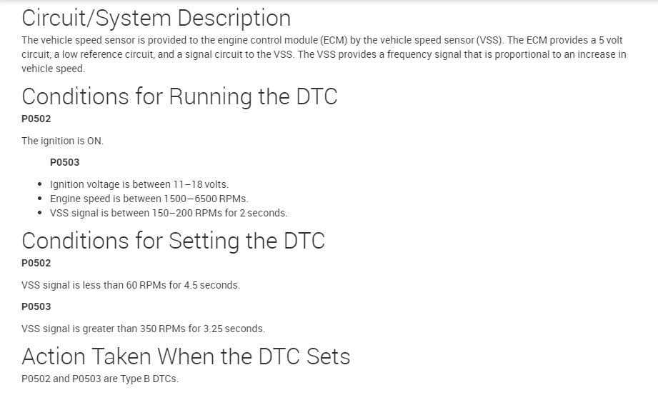

This vehicle, when cold after cranking, will be driving fine and when hot, it stops shifting gears and when I diagnosed it, it shows P0502: Vehicle Speed Sensor. Then I disconnected the sensor connector and checked for power using test lamp, there was power, and I used DMM and checked for signal and there was 10.50-volts on signal line of the connector. Then I checked for ground, and there was ground. Could it be the speed sensor being faulty? And how do I remove it from the transmission?

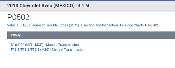

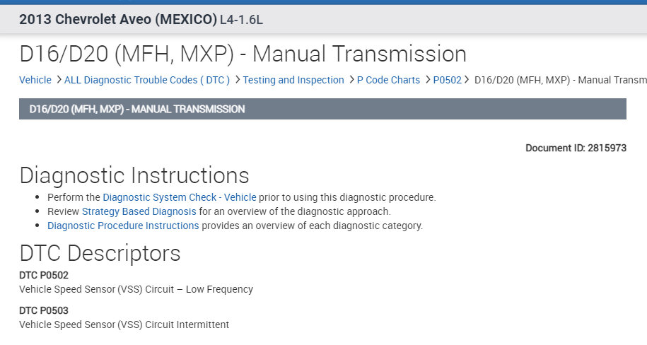

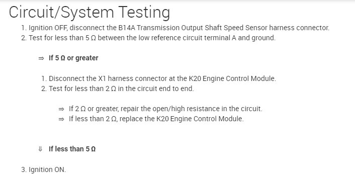

I would be happy to help, but I need some confirmation. According to my manual, the code is specific to a manual transmission. See pic 1 below.
I'm not sure if by accident you selected automatic, so let me know. If it is a manual, the diagnostics are provided. Let me know which you have, and I see what I can find on the output speed sensor.

The vehicle has an automatic transmission.
I take out time to inspect the vehicle yesterday and I came with the following observations
1. I unplugged the Input Shaft Speed Sensor, and the hold warning lamp went off and when you crank and engage gear, the gear will engage smoothly without hard shift.
2. I also noticed that the 2-fault codes that normally return back are P0502 and U0100- lost communication with TCM/ECM.
So, I need a communication diagram of TCM and ECM together with junction connector X105 and X205 location, let me trace out where communication fails.

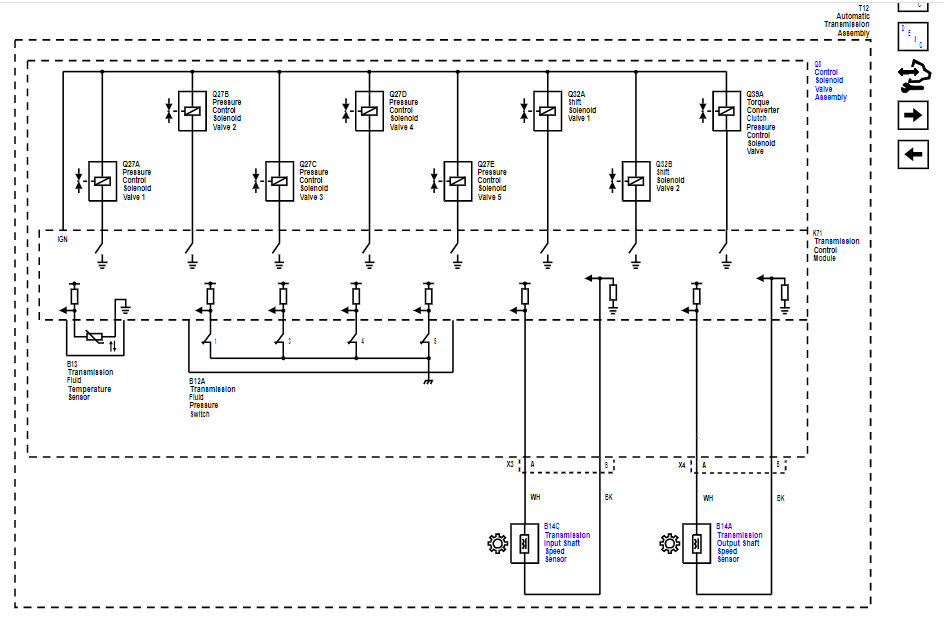

There's a short to voltage between the input shaft speed sensor and the transmission solenoid. I need a diagram of the transmission solenoids and for input shaft speed sensor to separate them and solve the problem.
Jan 29, 2023 at 4:42 AM

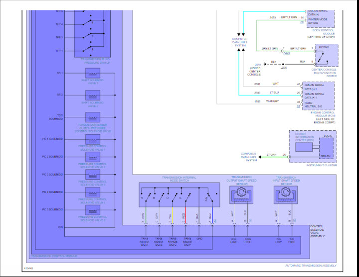

  • 110,248 POSTS
The only schematics I have are the OEM ones. Take a look through what I attached and let me know if that is what you needed.
Jan 29, 2023 at 7:13 AM
MALLYBOY
  • 329 POSTS
This didn't show how cables run from TCM to solenoid assembly and how they enter into each solenoid.
Jan 29, 2023 at 3:05 PM
  • 110,248 POSTS
Are you looking for a schematic or a routing diagram?
Jan 30, 2023 at 8:23 AM
MALLYBOY
  • 329 POSTS
Routing diagram, the p0502 always returns.
Jan 30, 2023 at 1:17 PM
  • 110,248 POSTS

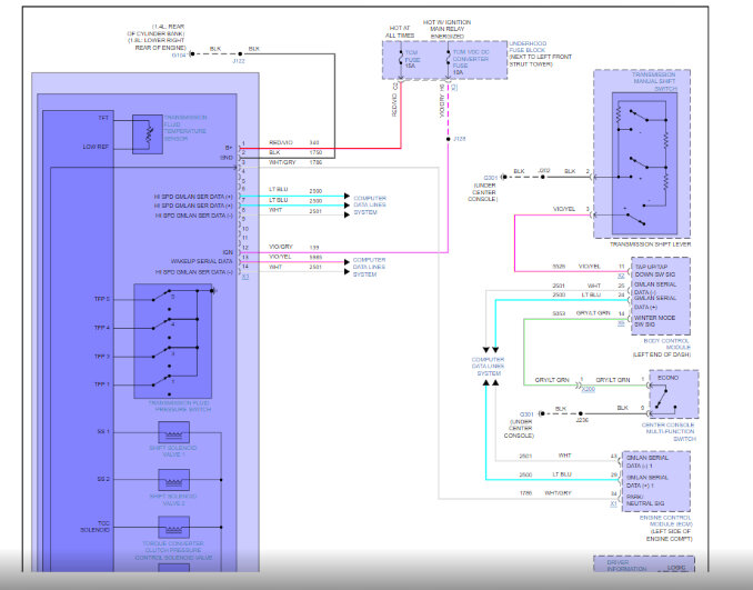

As far as routing through the vehicle, I have no manual that provides that information. Also, the code you provided only shows up for a manual transmission, so I asked the boss. He questioned if it is a Sonic, but the code still comes up for a manual transmission.
I attached schematics for an automatic transmission. Let me know if it helps.
Jan 31, 2023 at 9:42 AM
MALLYBOY
  • 329 POSTS
This diagram is not bright, try to brighten it and resend it and resend.
