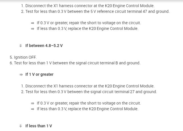

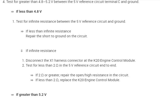

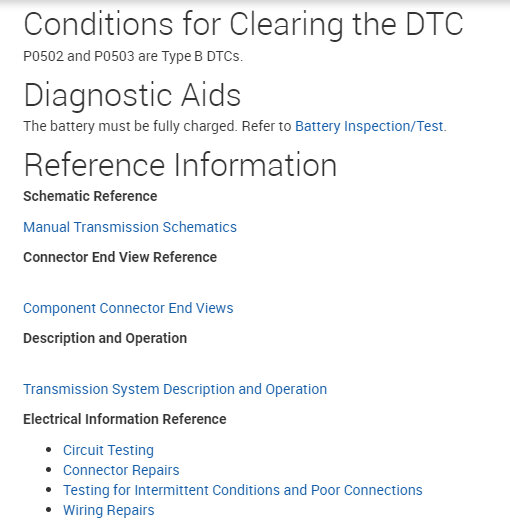

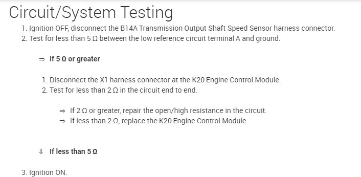

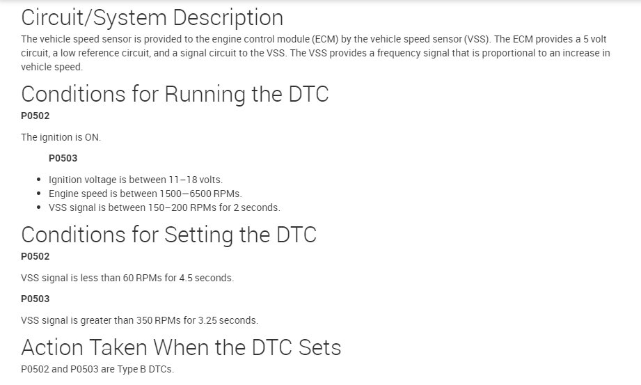

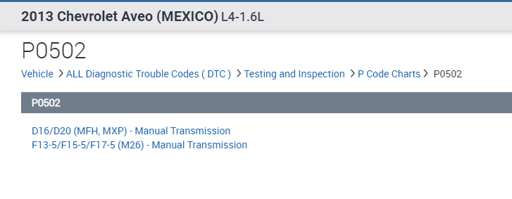

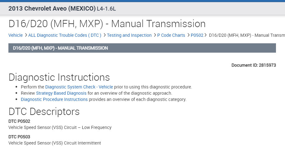

I would be happy to help, but I need some confirmation. According to my manual, the code is specific to a manual transmission. See pic 1 below.
I'm not sure if by accident you selected automatic, so let me know. If it is a manual, the diagnostics are provided. Let me know which you have, and I see what I can find on the output speed sensor.

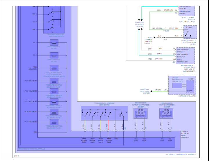

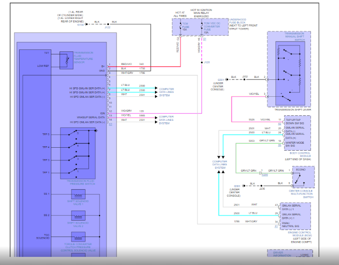

So, I need a communication diagram of TCM and ECM together with junction connector X105 and X205 location, let me trace out where communication fails.

There's a short to voltage between the input shaft speed sensor and the transmission solenoid. I need a diagram of the transmission solenoids and for input shaft speed sensor to separate them and solve the problem.

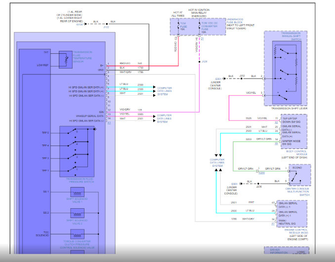

The only schematics I have are the OEM ones. Take a look through what I attached and let me know if that is what you needed.

This didn't show how cables run from TCM to solenoid assembly and how they enter into each solenoid.

As far as routing through the vehicle, I have no manual that provides that information. Also, the code you provided only shows up for a manual transmission, so I asked the boss. He questioned if it is a Sonic, but the code still comes up for a manual transmission.

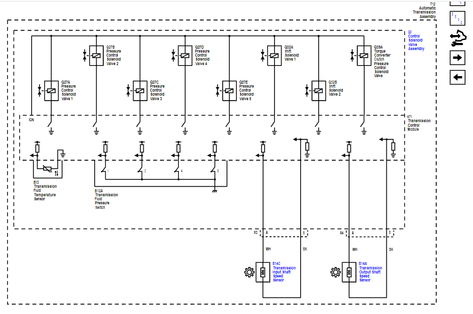

I attached schematics for an automatic transmission. Let me know if it helps.
Jan 31, 2023 at 5:42 PM
MALLYBOY
  • 329 POSTS
This diagram is not bright, try to brighten it and resend it and resend.
