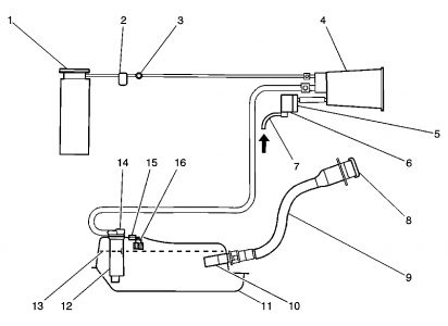

My Daughters Aveo's check engine light just came on and is hard to start sometimes and runs rough. I took it to Auto Zone to have it read and the read out did not list a real fix to the problem. They did look up some possibilities to the problem but were not sure where the problem might be. They were looking at either the fuel pump relay or the A/C relay as the problem. The A/C has not been cooling the car very well over the summer and is just blowing cool air on max A/C. Do you have any thoughts on what the problem might be? She does have regular maintenance done on the vehicle.

If you have the print out they may have done post the codes and I will decipher and give you possible causes and test proceedures.

CBVET57
Hi! Thanks for your quick responce.
The troubleshooting code is P0446 for OEM Brand Domestic. The definition given on the print out is EVAP (evaporation emmission system) purge/vent
solenoid circuit condition
Explanation
The solenoids & system wiring are monitored for opens or shorts
Probable cause
Purge or vent solenoids defective
Check connector & wiring
Fuel saturated vapor canister
Failed EVAP vent solenoid
Thats all that is on the print out. Hope you get get something from it.

Ok, I know the below info me be a bit much for you to handle since there are some special tools need....
However, the one thing you can do is look at the diagram of the EVAP System follow it and check for Kinks, remove if possible and check for blockages....
If you feel you can do most of the below and would like for me to post most testing for the evap solenoid and all let me know....

Schematic Reference Evaporative Emissions Hose Routing Diagram
https://www.2carpros.com/forum/automotive_pictures/188069_07aveo_EVAP_1.jpg

An intermittent condition could be caused by a damaged EVAP vent housing, a temporary blockage at the EVAP vent valve inlet or a pinched vent hose. A blockage in the vent system will also cause a poor fuel fill problem.

1.Ignition OFF, remove the fuel tank filler cap. 2.Ignition ON, observe the scan tool fuel tank pressure sensor voltage parameter. Verify the FTP sensor voltage parameter is less than 4 volts. à † If greater than 4 volts refer to DTC P0452 or P0453. 3.Start the engine. With a scan tool seal the EVAP system using the EVAP purge seal function. Command the purge open to 20 percent. Seal the system at -8.00 in H20. Exit the system seal. Verify the FTP sensor pressure parameter decreases to 0 in H2O. à † If the scan tool FTP sensor parameter does not decrease, check for a blockage or restrictions in the EVAP vent hose, or replace the EVAP vent solenoid valve.

CBVET57
Hi! I received your e-mail the other day and really could not do any of it except the first part about cleaning and checking for kinks in the EVAP hoses. I was looking for some possible simple fix so I would not have to take it to the dealer to determine what the problem was. I went to look at the EVAP system & couldn't find it & went to get a Haynes manual & they haven't made them yet. I fould some hoses near the gas tank but i'm not sure if they are with the EVAP system or not. I did notice that when I tried to start the car, it was turning over slow. I took it to Advance to get the battery checked & found that it has a bad battery. The gentleman that helped me checked the code again and said that it could be the gas cap causing the code. I got a new battery & gas cap yesterday and have not had a repeat of the code yet and the car is running fine. I don't feel that you answered the question to my satisfaction & I ended up solving the problem on my own. How do I go about getting a refund on the donation. I appriciate you trying to answer my question but it was not what I was looking for.
