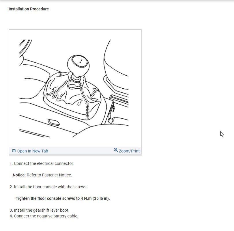

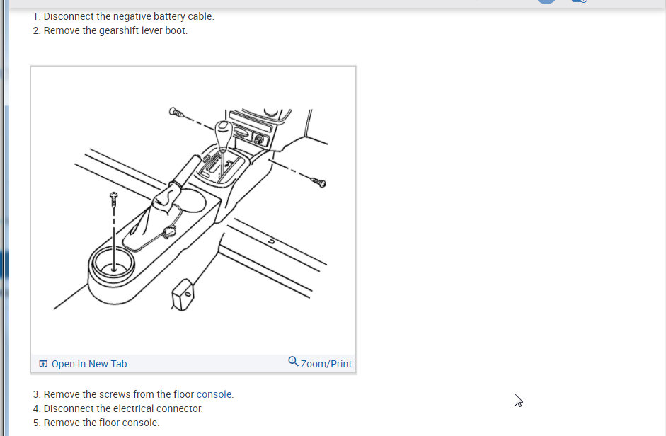

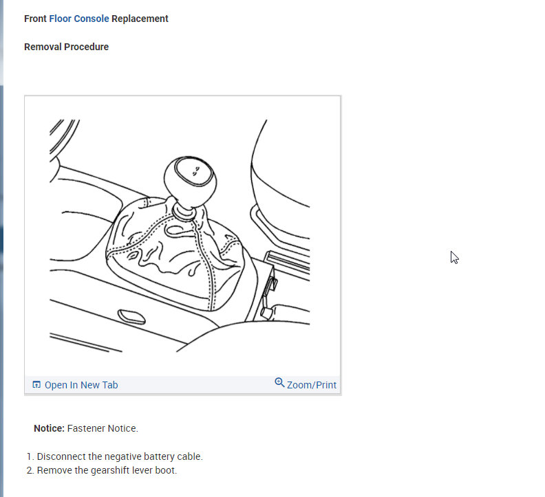

I need to clean hold switch. I need to know where bolts are located to remove console.
Apr 12, 2021 at 9:10 AM
Take a look at the attached info from the manual that shows the screw locations. Check out the diagrams (Below). Please let us know if you need anything else to get the problem fixed.Let us know if you need more info on this. Thanks
