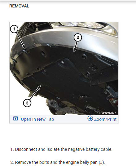

Replacing the front bumper after a collision, the bumper is broken and needs to be replaced. there not bolted but I'm just not sure how they are fastened or how to remove.
Feb 3, 2024 at 12:38 PM
  • 110,194 POSTS

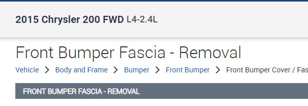

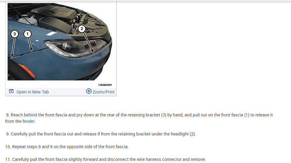

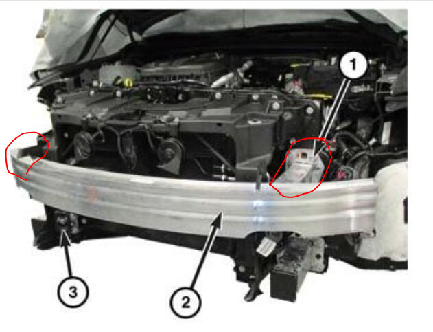

I'm not sure if you are referring to the bumper cover or steel bumper/bumper mounts.

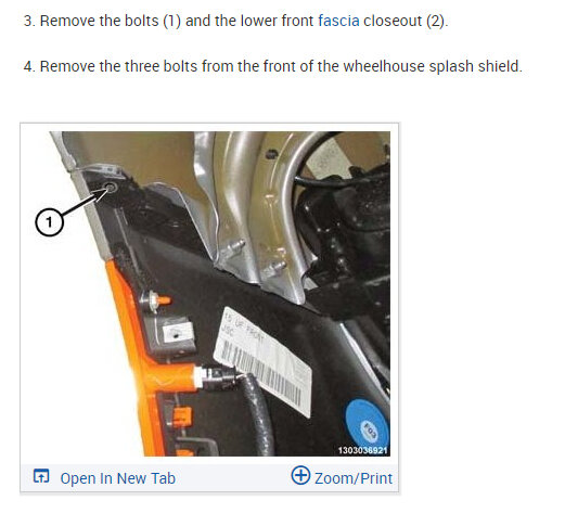

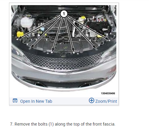

If it is the mounts/steel bumper, 4 bolts on each side of the bracket hold it in place. See pic 1 below.

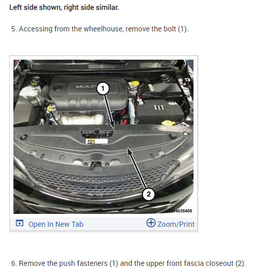

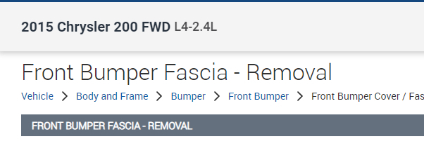

If you are referring to the bumper cover, the remaining pictures explain how it is removed. Installation is the opposite of removal.
Let me know if this helps.

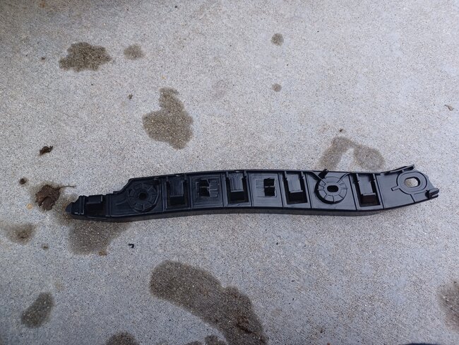

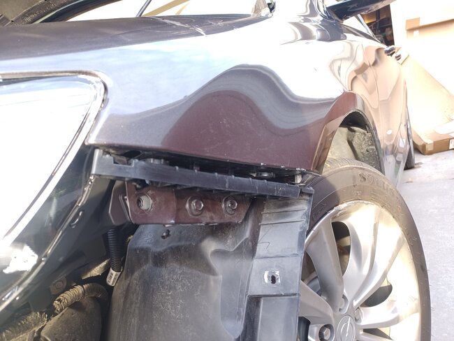

I ment the bumber brackets that are under the head light assembly, sorry
Feb 3, 2024 at 7:18 PM
  • 110,194 POSTS
No problem whatsoever. Is it possible for you to take a pic of what you are referring to and upload it for me to see? I suspect the fascia will need to be removed to access anything under it, but anything is possible.
