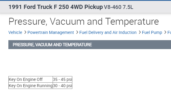

I don't think it's clogged. When you checked the fuel pressure regulator vacuum hose, did you check to see if there was a vacuum to it with the engine running? Also, was there any evidence of fuel in the vacuum hose?
Interestingly, the pressure you indicated is high. Actually, 43 is on the high end with the engine off, but 50 is too high regardless of if the engine is running or not when checked. That would explain the black smoke. It's getting too much fuel. See pic 1 below.
Let me know if you checked the regulator.

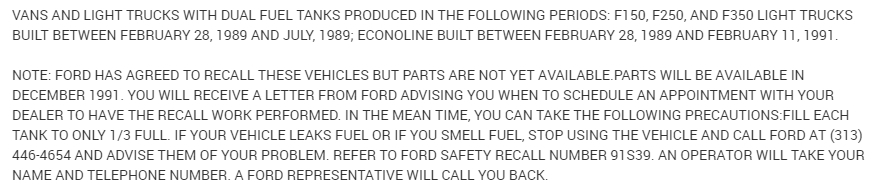

Yes, I checked it koeo40 PSI and 50 if it's hot under the hood running pressure is 38PSI, but it falls off after a short priceless than 20 until I flip the switch and it goes back up. I replaced switch still doing same thing maybe it's the valve.
Oct 6, 2022 at 2:11 AM
  • 110,194 POSTS

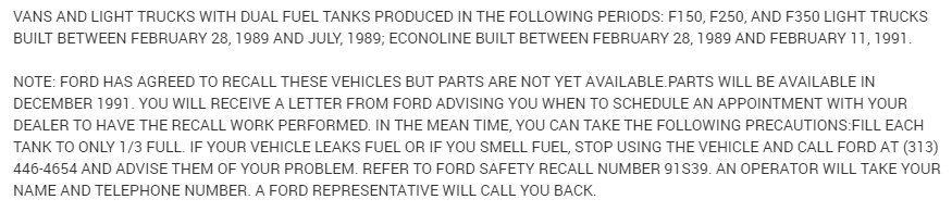

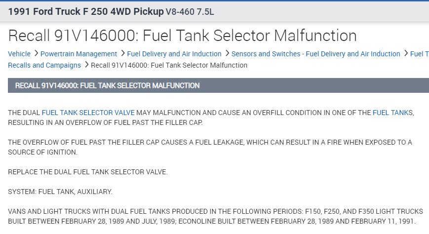

That is about the only thing left. I know years ago; the OEM valve was recalled because it would overfill the opposite tank. I attached the recall below just so you have it as a reference.
Let me know your thoughts.
Oct 7, 2022 at 6:56 PM

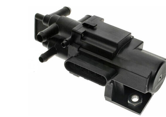

I haven't done anything to it but drive it the last couple days and it's seemingly getting better, I can drive without hitting switch. I'm looking for that valve but I can't find it where might I look or do you have a picture ?
Oct 11, 2022 at 5:52 AM
  • 110,194 POSTS
I can't seem to find a pic in my manual. However, they are normally on the inside of the frame rail after the fuel filter and before the engine compartment. If you follow the fuel lines from the tanks toward the engine compartment, you should find it.
I found a pic online and attached it below.
See pic.
