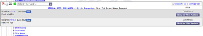

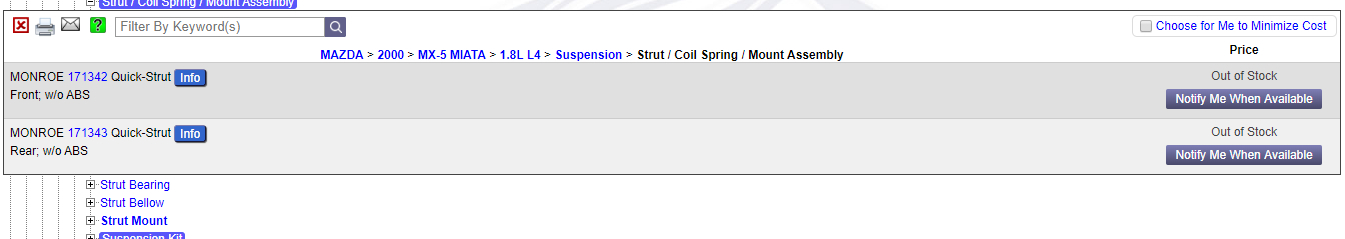

So I replace the shocks but still had the problem just not as bad. I've been replaced the springs with used springs from a much newer Miata. The pump stopped problem was still there on the right rear. And when I make a turn either direction into a parking lot it hits very hard on the right rear. If it's not the shocks or the springs what other part can cause this problem?
Oct 5, 2019 at 9:43 PM
Good morning.
I would use only new springs. Shocks do not hold up a car, it just stabilizes it.
The springs hold the height.
I attached the Monroe quick strut part numbers for you. You can call around and see if anyone has them.
