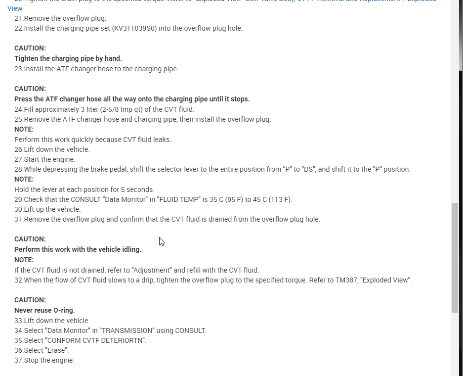

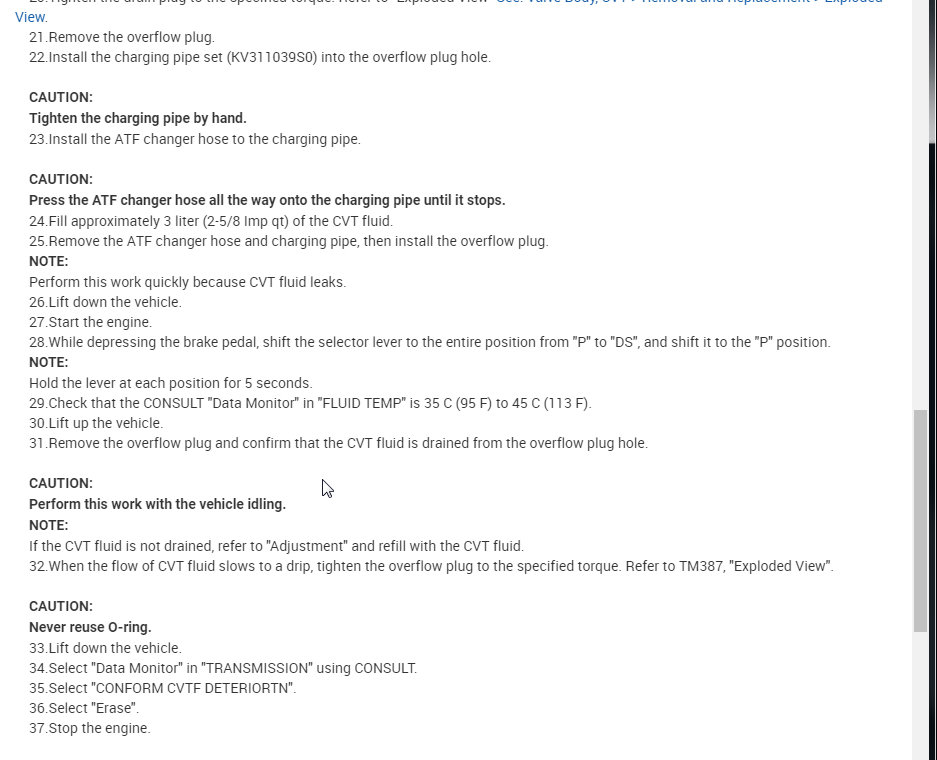

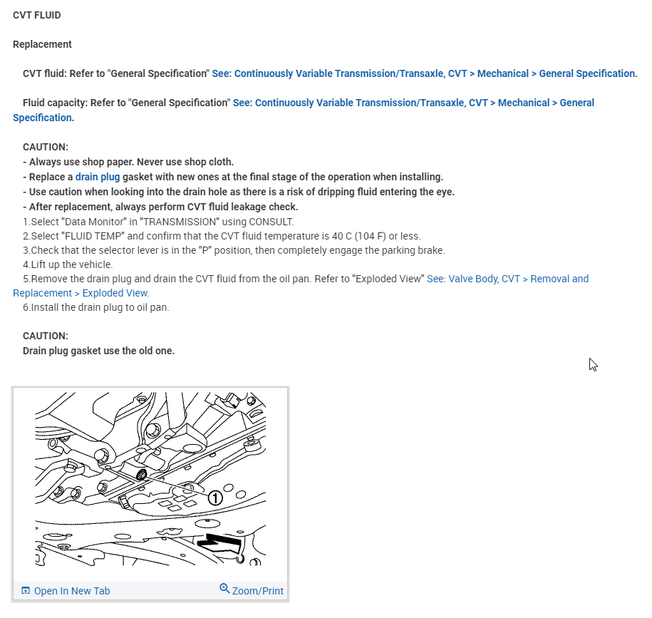

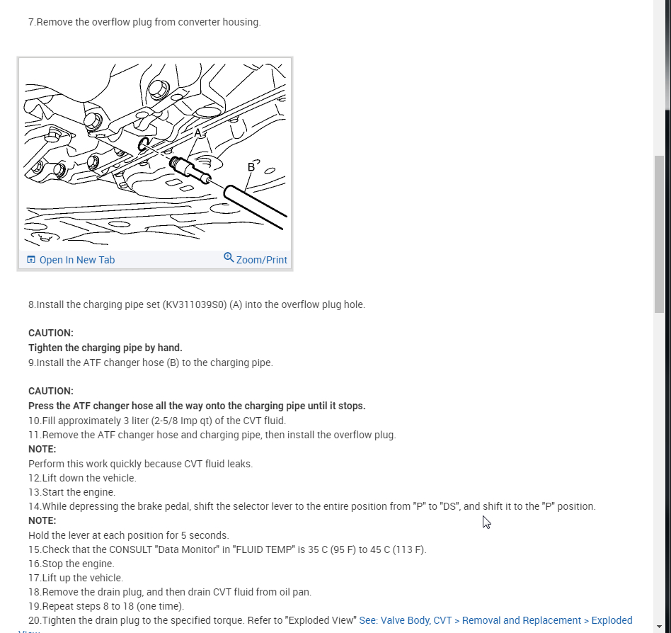

Unfortunately, it appears you have a CVT transmission which means you probably don't have a dipstick to check the fluid. So I attached the process on how to fill the fluid. Basically you want to pull the overflow plug and see if there is fluid in the unit. However, if we identify the fluid as transmission fluid then this is not needed.
Let me know what you find and we can go from there. Thanks.
