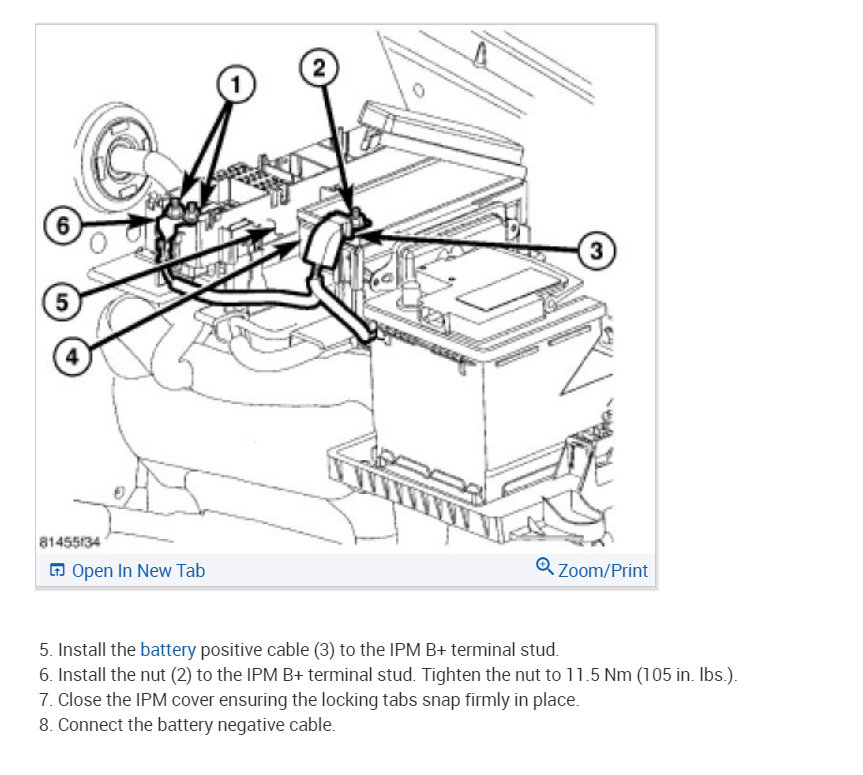

hooked the battery back up after three days of being unhooked and tried to start it and nothing happens?
190,000 MILES • 3.7L • V6 • 4WD • AUTOMATIC
RHOADESD91
So, I hit a deer on the way home the other evening and broke the bumper grille and headlight and the plastic on the radiator. So, I replaced all that and got it all squared away and found a plug that goes to an impact sensor. When I hooked the battery back up after three days of being unhooked and tried to start it nothing happened other than the dome light coming on. nothing else comes on; no horn, headlight, or anything. I have checked the fuses and they all seem to be good. Please help.
Aug 7, 2022 at 11:51 PM
  • 55,694 POSTS

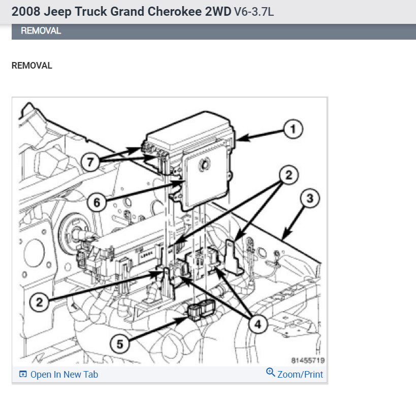

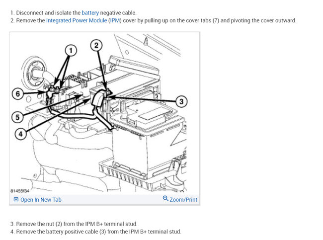

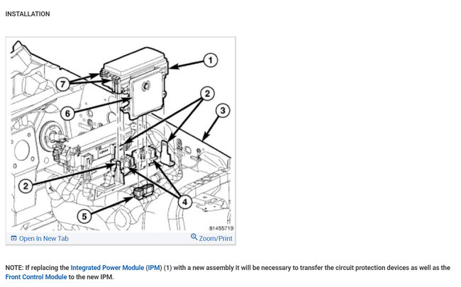

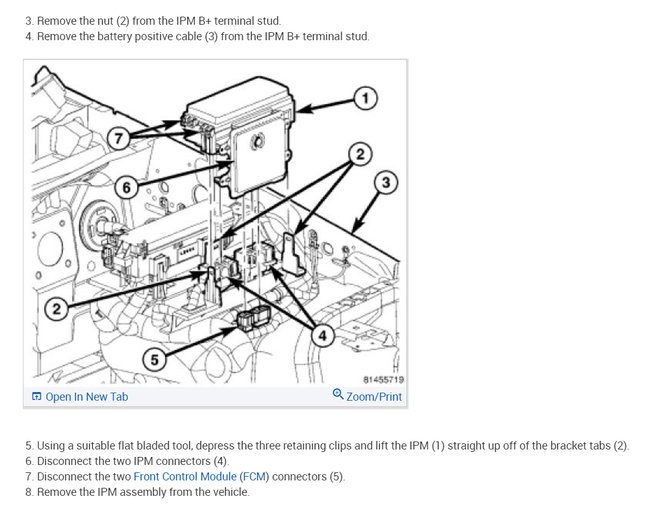

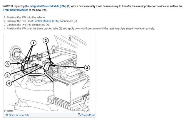

Is the battery in good shape? If so, it sounds like the IPM is bad which is common. To be sure you can get a CAN scanner from Amazon for about $30.00.
https://youtu.be/u-4syLc-ifQ
Here are the instructions on how to change the IPM out which is easy it-self learns there is no programming involved. Check out the diagrams (below). Please let us know what happens.

So, I got it going there was a wire that came loose under the fuse box and while checking for broken grounds came across it. I hooked it and bam started right up. Thank you so much.
