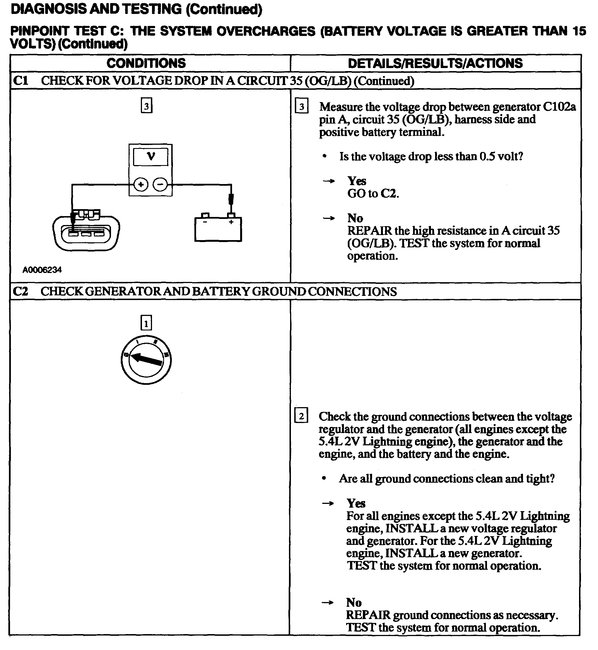

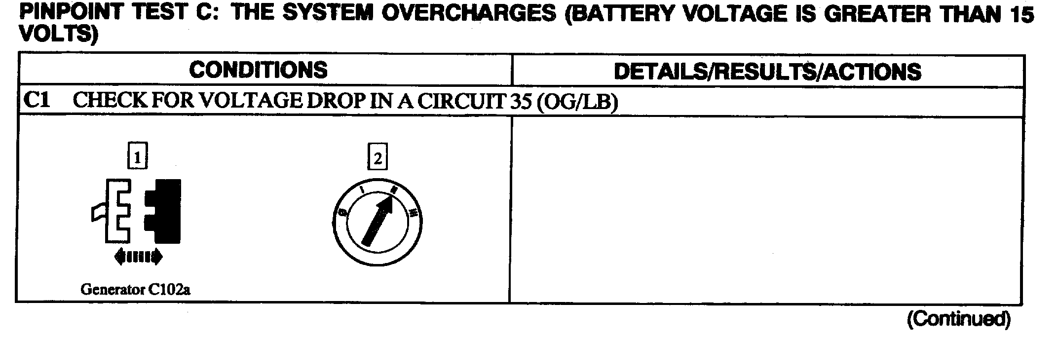

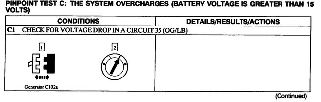

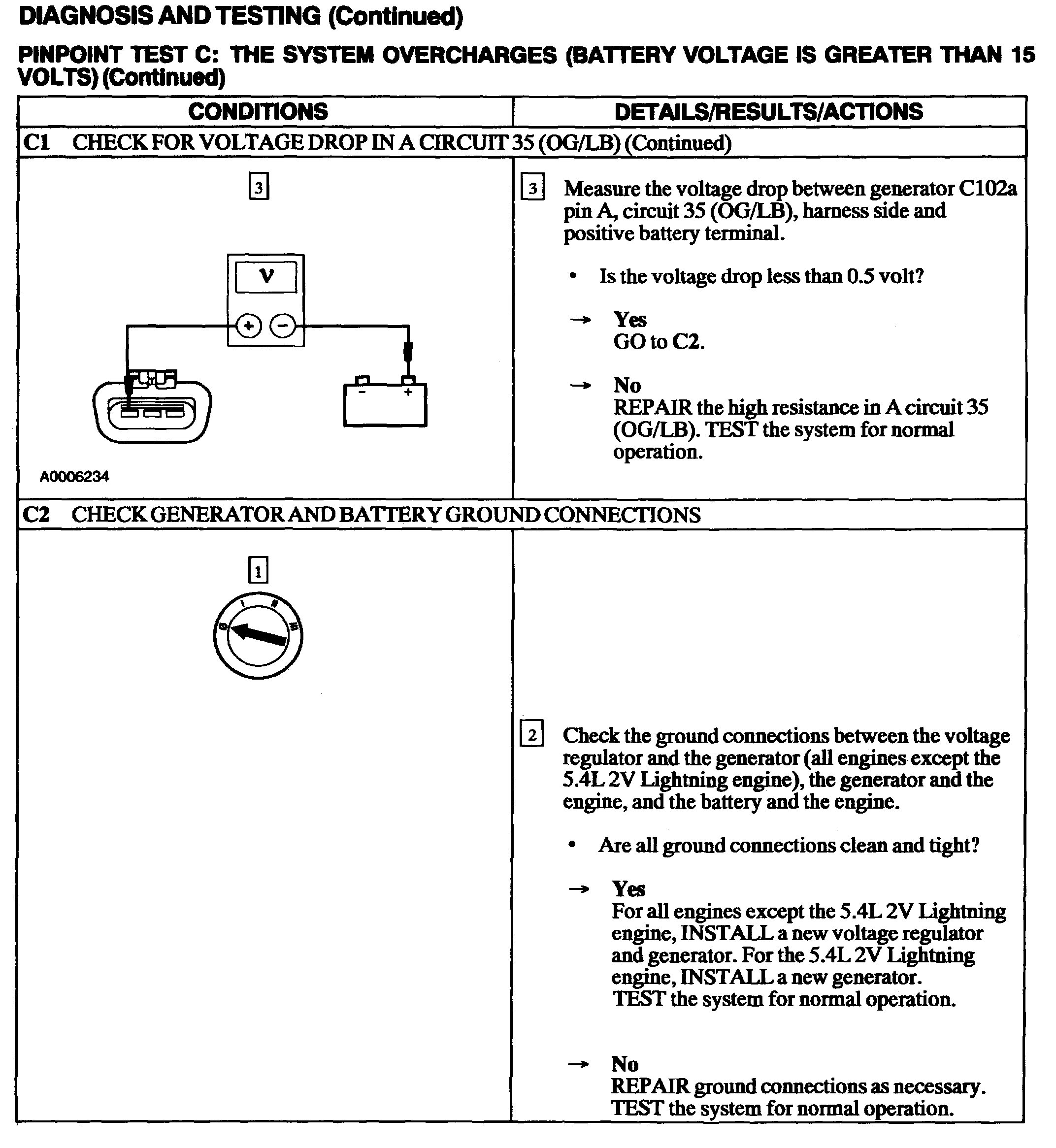

As far as testing, here are directions for checking for an overcharging system. Take a look through it and let me know if it helps. The two attached pics are actually the test procedures.
__________________________
2002 Ford Truck F 150 4WD Pickup V8-5.4L SOHC VIN L
Test C: System Overcharges (Voltage Greater Than 15 Volts)
Vehicle Starting and Charging Charging System Testing and Inspection Pinpoint Tests Pinpoint Tests Test C: System Overcharges (Voltage Greater Than 15 Volts)
TEST C: SYSTEM OVERCHARGES (VOLTAGE GREATER THAN 15 VOLTS)
C1
See pic 1
C1 - C2
See pic 2
