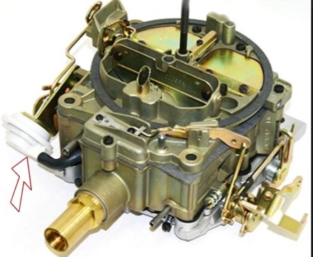

After cold start idle stays high too long. Sometimes choke sticks closed after a short run and is difficult to start. Car diesels when turned off after a short run.
It looks like the tension on the high speed idle cam is too tight, preventing the cam to rotate back to position in a timely fashion. This, in turn, prevents the choke from returning to the open position.
I have found, with my fingers, a small hex with what feels like a spring on the right side (passenger's side) of the carburetor just under the cam assembly which seems to be the tension adjustment I am looking for. However, I see no way to get any tool, even with a universal joint fitting, in place to make the adjustment.
Please give me, if you can, a procedure for clearing the area enough to make this adjustment. My Haynes manual seems to be useless in that regard and I do not want to start taking things apart that I do not have to.
Thank you, 88

most of the time this is no adjustment as they are not necessary. it is either not getting heated correctly or more like the choke linkage is full of dirt/oil take choke cleaner and clean all around the area and hold throttle open a little and work choke up and down and linkage while cleaning it. that may take care of it.

there is a screw that will slow or speed up that will ride on the high speed cam. we have no pictures of this, but screw comes in from back. i am sure that Is not your problem however and it is dirt/oil which should be cleaned with choke cleaner all the linkage on that side. you need to pull air cleaner off to see things. car should idle at 2200 rpm's when set or if you want lower to 1500 rpm's at the minimum.

if you don't put a tach on it you will never know what it's doing. I don't understand what you mean idling longer than it should when it's starter there are a couple of high idle stepson the cam one is very fast then it slows a little then slower before hitting regular idle which you need to know what normal warm idle is. the cam is controlled by the choke heater which is non adjustable. idle should be 700 rpm with solenoid disengaged and 800 with solenoid engaged there are a nut like for solenoid adj and a small screw for other unplug wire to solenoid and make that adjustment if solenoid is holding it higher then back off screw to solenoid until it goes to 700 then plug back in and it should go to 800 at least those are the only adjustments.

  • 55,851 POSTS
Hey 88,
It sounds like you have a primary choke pull of that has failed, we used to replace those all the time in the shop for this reason. I marked the part in the image below.
Please let us know what you find so it will help others.
Best, Ken
