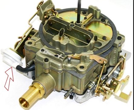

  • 55,433 POSTS
Hey 88,
It sounds like you have a primary choke pull of that has failed, we used to replace those all the time in the shop for this reason. I marked the part in the image below.
Please let us know what you find so it will help others.
Best, Ken
