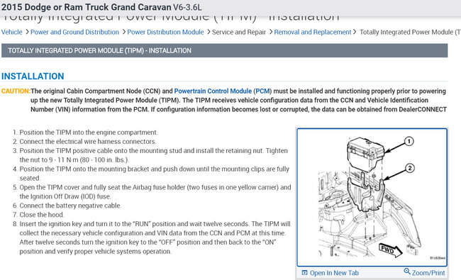

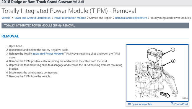

Here is how to change out the TIPM in case you need it. The TIPM is easy to replace because it-self learns. Check out the images (below). Please let us know what happens.
