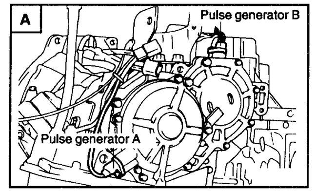

my car is a nissan quest 2007 , Automatic Transmission, It takes off well in the morning , but after some 1 mile or so it will not change to the next gear and will start crawling , no speed. But the amazing thing is that it speeds on R and on L but not on D. Can someone help me with a suggestion please.
Oct 29, 2018 at 1:00 AM
  • 55,694 POSTS
It sounds like a input shaft speed sensor is going out but to be sure. Here is a guide to help us run the codes:
Here is the location of the sensor below.
Check out the diagrams (below). Please let us know what you find.
Oct 29, 2018 at 2:58 AM
