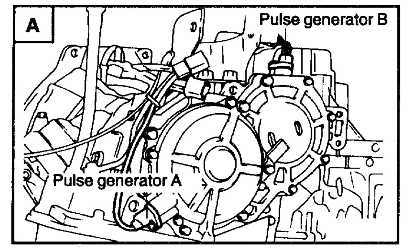

my car is a nissan quest 2007 , Automatic Transmission, It takes off well in the morning , but after some 1 mile or so it will not change to the next gear and will start crawling , no speed. But the amazing thing is that it speeds on R and on L but not on D. Can someone help me with a suggestion please.

It sounds like a input shaft speed sensor is going out but to be sure. Here is a guide to help us run the codes:
Here is the location of the sensor below.
Check out the diagrams (below). Please let us know what you find.

Admin, thank you for the response but my check engine light is not displaying. what i forgot to tell you last time was that I first changed the front shock, apparently they gave me a wrong shock an altima shock that couldn't even lift the car from the floor so i returned it and they gave me something that is now the same size with the one I am changing but after fixing it the movement of the car changed, its like something is not allowing the gear box freedom, I went back to the mechanic he drove the car and said there was no problem and one day as I was moving slowly to a junction I heard a big slipping noise , as if the gear stick or a rope previously under stress just unhooked, and since then, when i drive it doesn't change from D and after a little while it RPM will be far higher that the speed, it will be crawling. so i parked it and stopped using it but i need it back on the road, I appreciate your keen observation and professional approach, to diagnosis. I am quite grateful. please see if there is any further guide you can give me.
