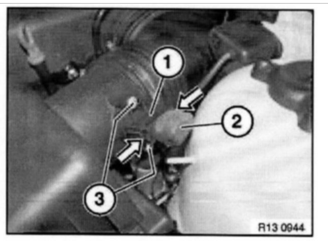

I would think the MAF sensor is your best bet for low performance and no codes, the rest would trigger a code.
Here is a guide to help you see what you are in for when replaceing the MAF sensor,
https://www.2carpros.com/articles/how-to-replace-a-mass-air-flow-sensor-maf

Not really it should respond instantly, How did you make out with the MAF? Here is a diagram to help us along.

Hi, thanks for the links/pics, I cleaned the MAF with recommended cleaner and reset engine adaptation. It is a bit better still. I ordered fuel filter and oxygen sensors, mine are original and mpg has been falling steadily (21-17 mpg). Also, even though the cats were found to be working, I still think your point about them being clogged is cause for concern, maybe the shop I took it to didn't find a Catalyst System Efficiency below threshold code and took that as them being ok. Why isn't this code showing if the cat(s) are bad?

Sometimes cleaning the MAF won't work and you must replace it. It is a good idea to do anyway with that kind of mileage.
