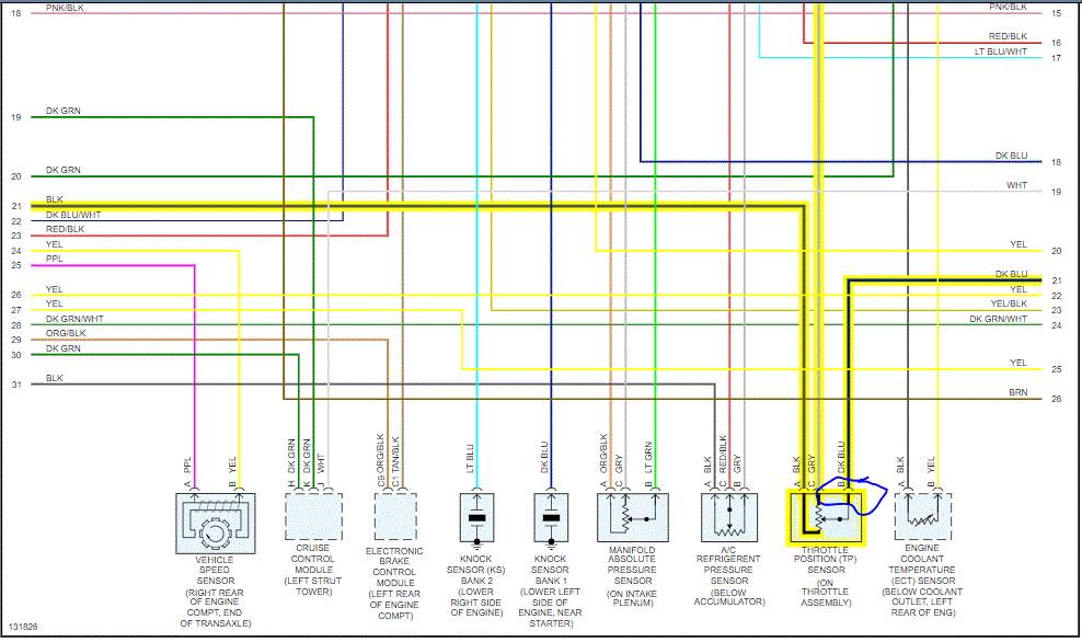

I attached a wire diagram for you to view of the TPS. What color wire did you test and found 5 volts?
The gray wire should have 5 volt reference.
I need the voltage from the dark blue wire at closed throttle with the key on.
Can you test that for me?

Okay, let us start over.
You need to back probe the dark blue wire with the key on. You should have ,5 to .75 volts.
when you open the throttle, it should rise to 4.8 smoothly.
Test that and let me know.

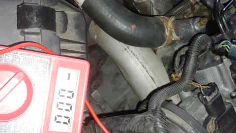

So here is video with key in on position and car not running. Yesterday i had steady readings. But now battery is at 100 %. I'm thinking i will buy role of proper wires and collars. And just re run them with new plug. Then check. If you think that's good idea. I have two different voltage testers and they're both doing the same thing batteries may be low in them so I'm going to change those batteries and try that before I do everything else. But what do you think about this video?
Sep 18, 2020 at 4:12 PM
The reason you have no readings is because you have the connector disconnected.
Put the connector back on and back probe as I stated in my previous response. You will get no readings with it disconnected.
Sep 18, 2020 at 4:19 PM

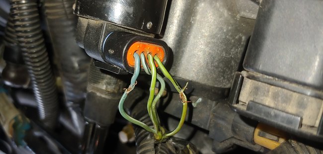

As you can see I have a dark blue wire next is a light blue wire with a black line it could be great. Then there is a green wire then there is a green wire with a black line. Your diagram shows black wire and opposite end of blue wire. So I use the green wire with a black line on the opposite end from my blue wire for my positive and negative on the meter I still I'm getting different readings. One time is jumping up and down the next time it's showing 1.49 another time it's showing 0.01. I cannot get an exact reading. I also tried grounding my meter 2 a bolt on the body of the car with vice grips and to the battery and I get the same thing all over the place.

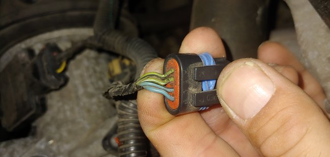

I have 2 Monte Carlo SS's. One I'm working on is a 2000 my other one is a 2004 this is a picture of the two thousand four wires they are blue in green same as on my 2000.
Sep 18, 2020 at 5:17 PM
VICMIDD
  • 18 POSTS
Sorry picture didn't load. here it is:
Sep 18, 2020 at 5:19 PM

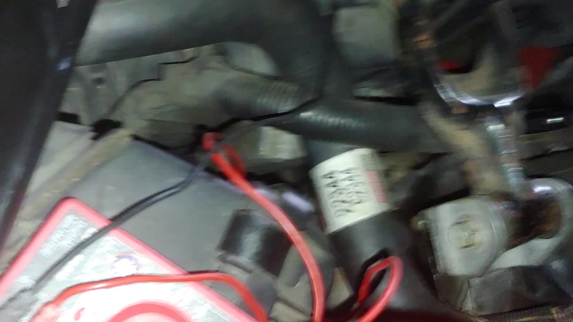

I got busy yesterday. And figured i have time before bears game today. So i have new battery in both testers. And i'm getting 0.64 steady with throttle closed. And when i open throttle it goes down to around 0.50 then comes back to 0.64 and then stays there.. So i guess the TPS is bad. It all began after i put new intake gasket and cover. when i first started it the idle was really high at 3,000 RPM's. So I went ahead and changed the MAP sensor that did not work. So I changed the TPS that did not work. So I changed the temperature sensor that did not work. So i changed the idle air control or idle control and that worked. The idle came down. But then when I drove the car the RPM's were really high when shifting which is what we're discussing now. So I bought a second TPS. That's the one we're testing now. And clearly I got two bad TPS. I'm going to buy another one and try it. If it ends up messed up something is causing that to happen.

Plus i really didn't want to tell you because it's one of those mistakes you look around hoping no one seen you. Because you know better that to do it and not notice sooner. But here goes. The whole time i was testing the Idle Air control. Because it was the last thing i changed. And that's why both my 2000 and 2004 have 4 wires instead of 3. So stupid it's funny. Sorry. But the message before this is testing the TPS.

LOL, do not worry about it.
Yes, the TPS is bad. Replace it and retest to verify.

Okay, so all this time I was testing the wrong thing. Because my idle air control brought my idle down for some reason I kept thinking that was the throttle position sensor. And I know the difference I've changed them in many cars before. But thanks to you I finally stopped and looked at what I was doing in realized I was testing and changing the wrong thing. I put new TPS in and everything is great. thank you for your help. That was all my bad I can't believe I really did that but I did.
