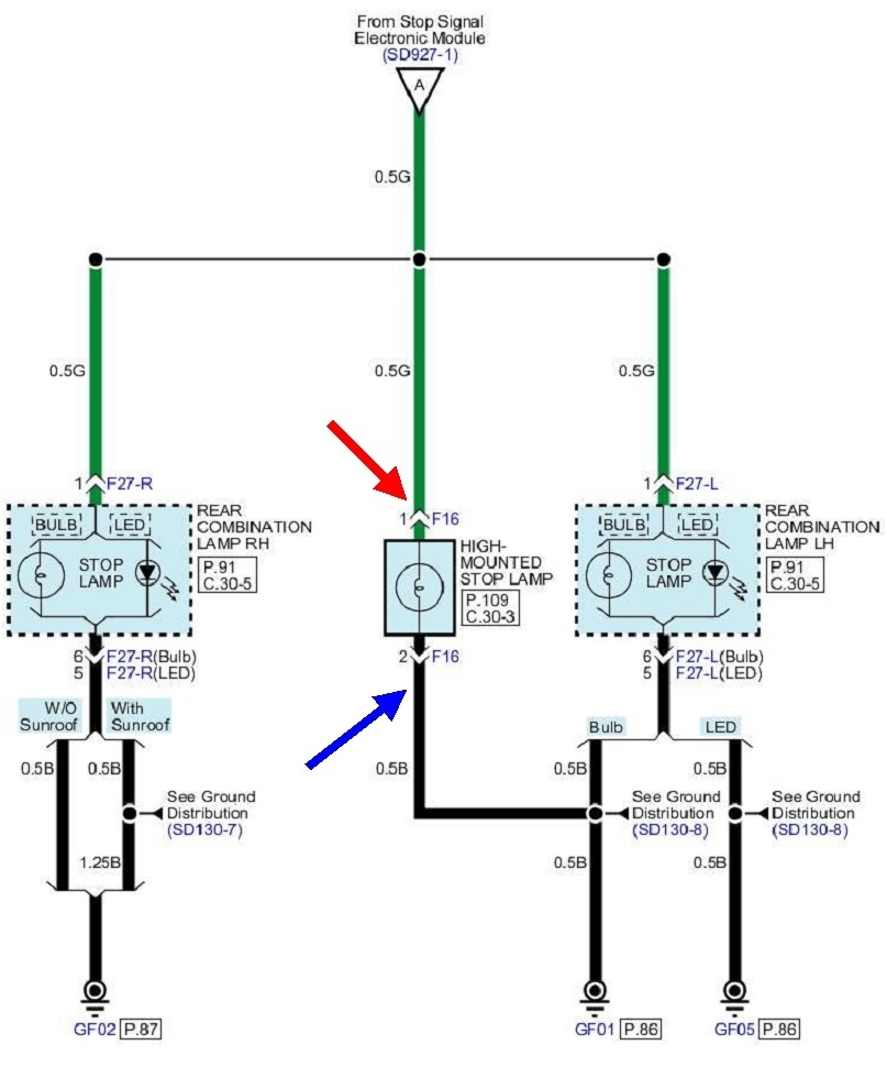

I took my vehicle in for inspection. It flunked with a driver's side rear brake light out and the High Rear Brake lights in the rear hatch also out. I replaced the stop light bulb on driver's side rear stop light, and it works, as does the left rear brake light. I also replaced 2 mini bulbs inside the rear hatch's High Rear Brake lights, but still no work. I removed the plastic frame that holds the 5 mini bulbs and saw one or two bulbs were loose. I carefully bent the contact wires on the bulbs and the bulb holder and tested it for continuity with a multimeter. The bulb frame passed the continuity test. So, if DC current gets to the upper rear hatch, the bulbs should light up. Sadly, still the High Rear brake lights refuse to light. After more research I found out many Kia Soul's had problems with two wires running from right brake light to High Rear brake light breaking. After inspection, of said wire at upper hatch door, I feel i should slice off the electrical tape wrapped around the high Rear Brake light wires where they split off the other wires. That way I can test that last wire run inside the hatch door. If those wires fail, I have replacement wires. Since the rest of the brake lights work, I assume the brake switch and fuses are good. I did swap out two brake fuses on the Interior fuse block and swapped the single brake fuse under the hood. I check the brakes with my keys in the ignition, the wheels chocked and a brick on the brake pedal.
What else should I check?

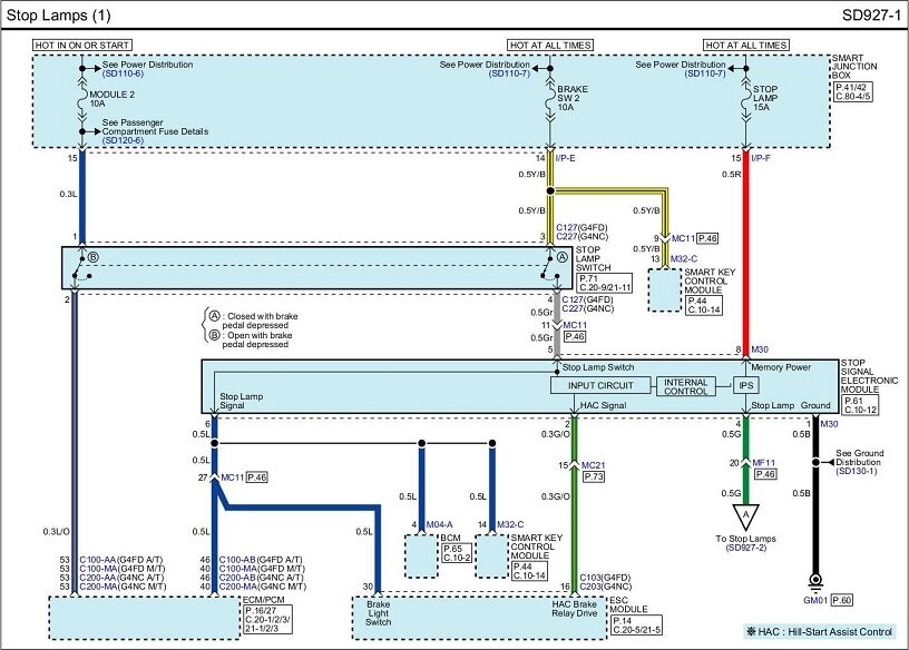

You're about 20 steps ahead of where anyone else would be. I can offer a few suggestions.
Here's the diagrams for your brake light circuit. We only are concerned with the second one. If it's too small to read, try copying it into a typing program such as MS Word where it can be expanded, or I can cut it into pieces that I can expand for you.
We know there's 12 volts getting to point "A" on top since the left and right brake lights work. That just leaves the 12 volt and ground wires you're already looking at. You didn't say how you tested for 12 volts feeding those center lights. A somewhat common point of confusion can be introduced if you unplug a connector to take the voltage reading. When a wire breaks from repeated flexing, there could be just one tiny strand left intact, or it could have broken completely, then arced between the break, leaving a carbon track behind inside the insulation. Either way, not enough current can get through to run a light bulb, but if unplugged, a very little voltage can sneak through for the voltmeter to incorrectly see the 12 volts, giving a misleading reading. To prevent that, recheck the 12 volt wire while the connector is plugged in.
If this is difficult to follow, think of stepping on a garden hose so it is 99 percent blocked. If you start with 50 psi at the faucet, you'll also have 50 psi at the nozzle, as long as the nozzle is closed. Open it and almost no water will be able to flow, and you'll have 0 psi everywhere after your foot. The break in the wire equates to your foot on the hose.
Use your specialty tool, (brick), or a stick between the seat and brake pedal, then check for 12 volts on the green wire, (red arrow). If it's missing, that is the wire with the break.
If you do have that 12 volts, next, with the assembly still plugged in, measure the voltage on the black ground wire, (blue arrow). If you find 12 volts there, that black wire has a break between the assembly and the splice. The voltage test is far superior to a continuity test. All that's needed is one strand of wire still intact to get a "good" reading but that won't allow enough current to pass to run even one light bulb.
As an alternative, if you're in a circuit where you absolutely have to unplug a connector to take a voltage reading, use an older-style inexpensive test light instead. Unlike with digital voltmeters, test lights use a standard bulb that requires current flow to work. That forces current to try to flow through a break and can make a dead circuit show up where a voltmeter won't.
