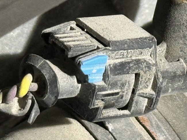

How to remove the High-Pressure Fuel Pump connector?
2015 CHEVROLET IMPALA
140,000 MILES • 3.6L • 6 CYL • 2WD • AUTOMATIC
FARMERW
I am unfamiliar with this type of connector. How do I release it to remove? I don't want to break it. See attached picture. It has a blue ear on the visible side.
It is only a 2-pin connector.

The blue tab is a safety to prevent it from coming off. It should slide out from the connector and then you should be able to depress the release and remove the connector.

thanks. The connector was quite brittle. Blue part broke but was able to maintain the key locking feature for re-installing. Thanks.

You are very welcome. As far as the connector is concerned, the heat causes them to get that way. If it didn't fall apart, you did good!!! LOL
