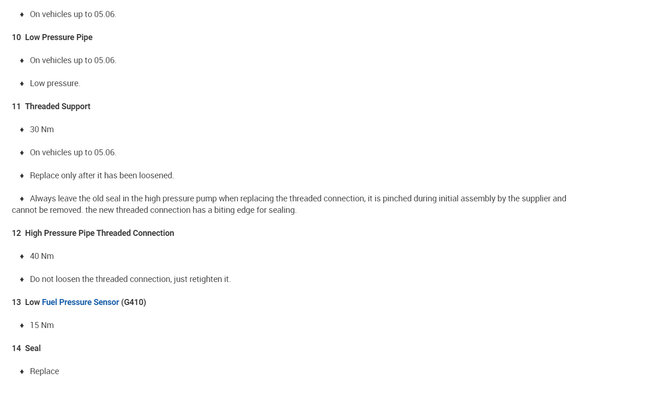

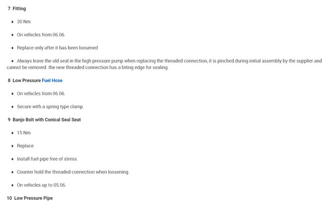

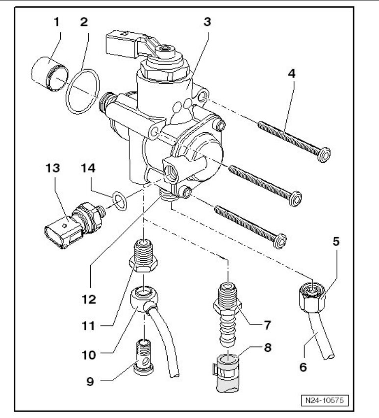

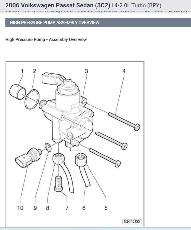

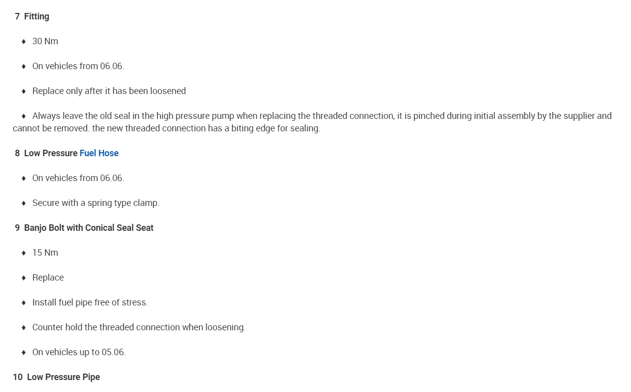

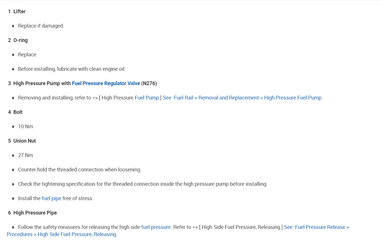

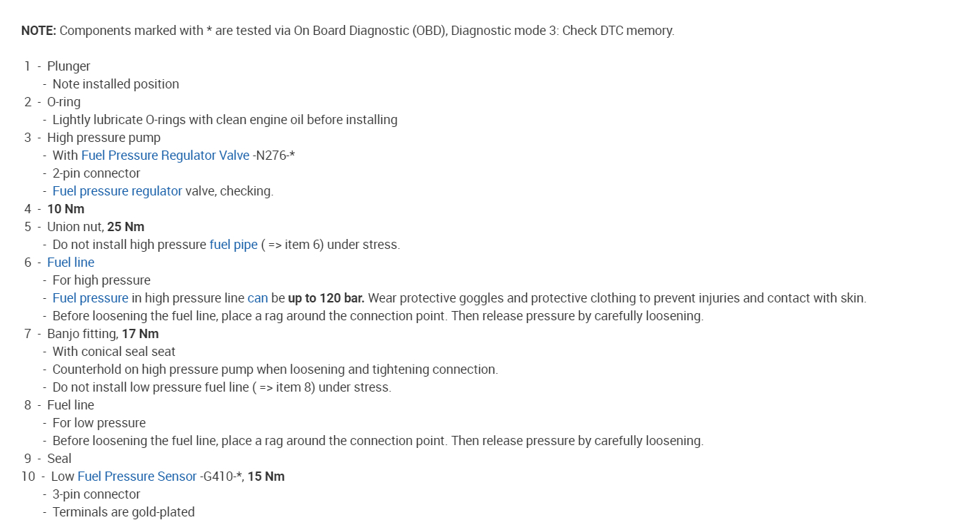

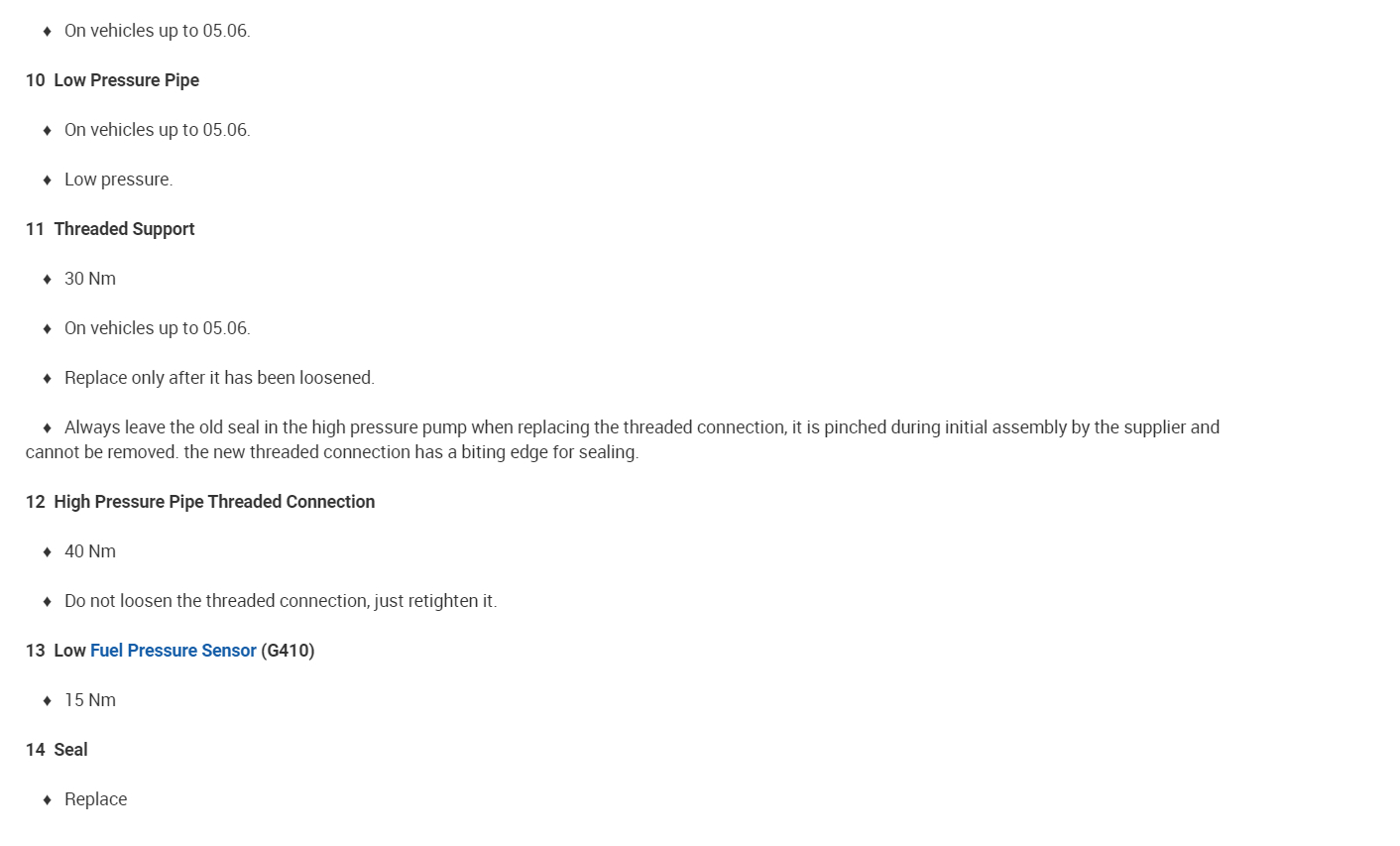

leaking gas, replaced the fuel pressure sensor, fuel pressure regulator.
it now leaks gas. from the picture right beside the fuel regulator is another fitting, which is where the gas is leaking from. pictures enclosed.
I tried to remove but it does not fit a 17 mm tried 18 mm which will not fit tried a 19 too large. does the high-pressure fuel pump need to be replaced?
Jun 9, 2023 at 4:33 AM
  • 55,797 POSTS
I don't see the pictures. It takes a bit on mobile, FYI. Here are the high-pressure pump arts try to point out what you are talking about so I can help. Check out the images (below). Please let us know what happens.
