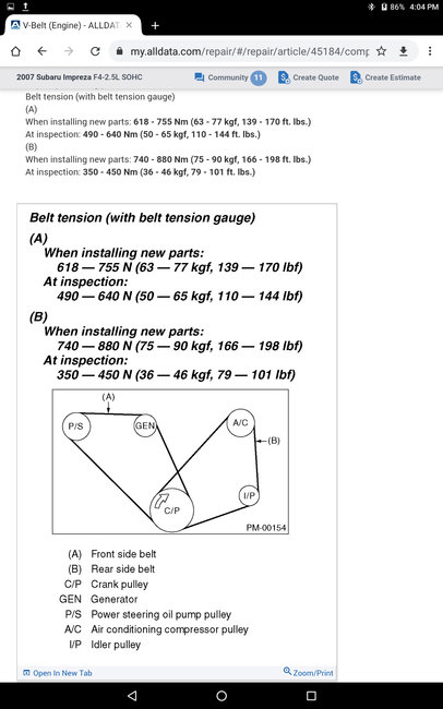

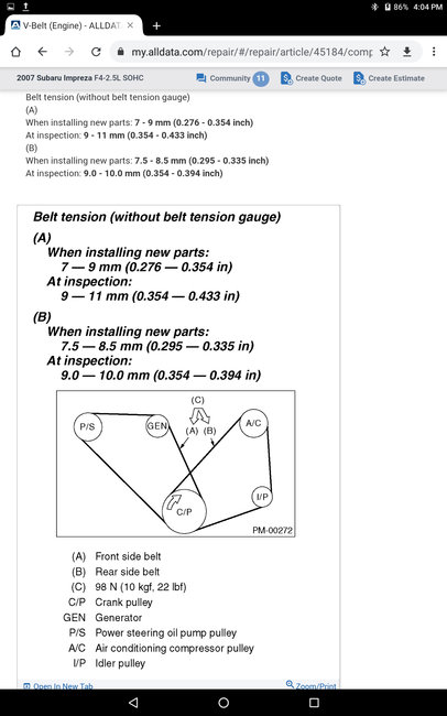

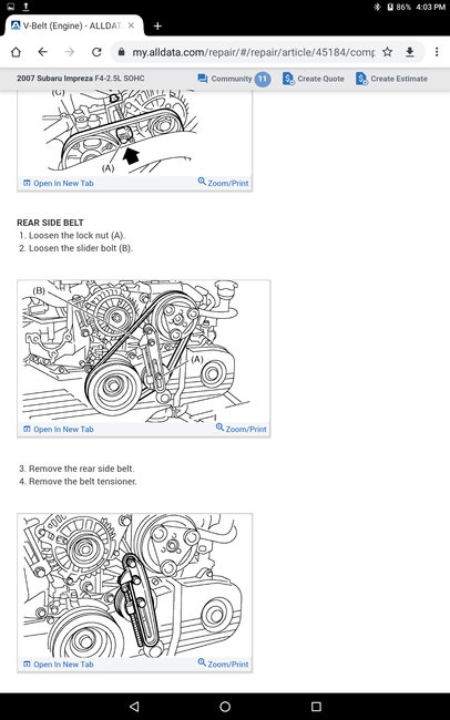

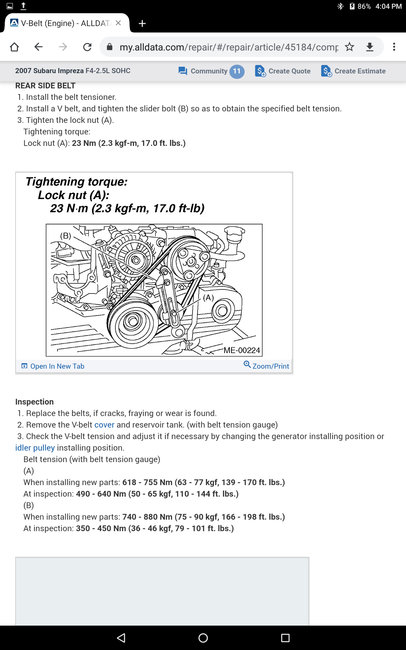

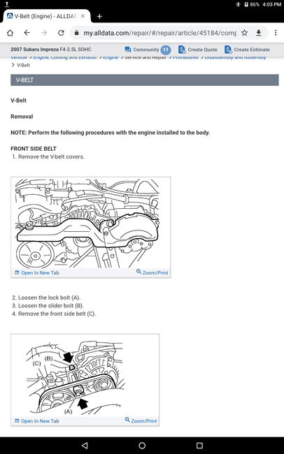

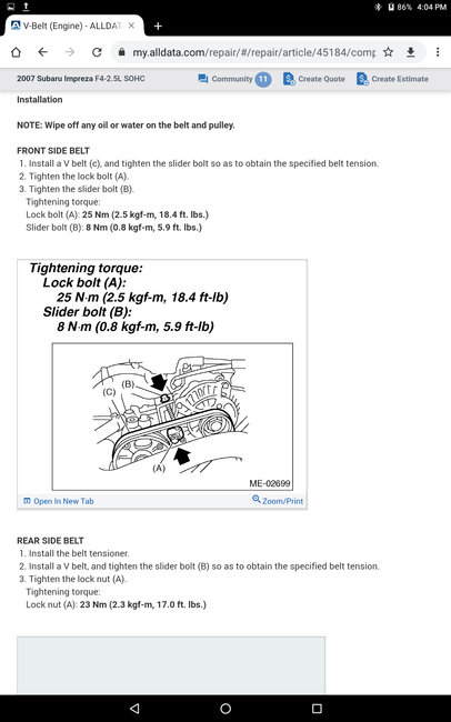

Hello, take the serpentine belt off, the one that drives the power steering pump, if I remember correctly that car has 2 belts, take them both off. start the car for a minute and see if the noise goes away. Then turn the car off and try to turn the power steering pump by hand. It sounds like the pump may be seizing up. While you have the belts off, try turning the alternator and the belt tensioner as well. See if anything is starting to seize up. Try turning the A/C compressor as well. Adding belt instructions as well.
