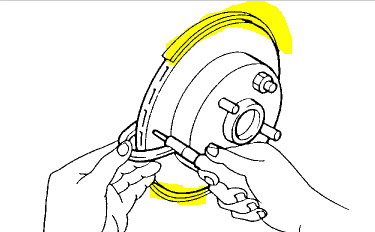

Based on what you described, I suspect it could be a few different things. Since the brakes were recently replaced, do me a favor. Behind the brake rotor is a dust shield. They can get bent and touch the rotor. Confirm that hasn't happened.
On the other hand, it could be a wheel bearing. If the sound is noticed when turning right, there is a better chance that the left side is bad. When turning right, the weight distribution changes, and more is placed on the left side of the vehicle.
As far as suspension, that wouldn't make a continuous squeal. Also, since applying the brakes doesn't change it, the brakes are likely fine.
Take a look at the pic below. I highlighted the dust shield in the pic. See if there is any evidence of it touching the rotor. Also, if the sound is loud enough, record it and upload it for me to hear.
See pic below.
