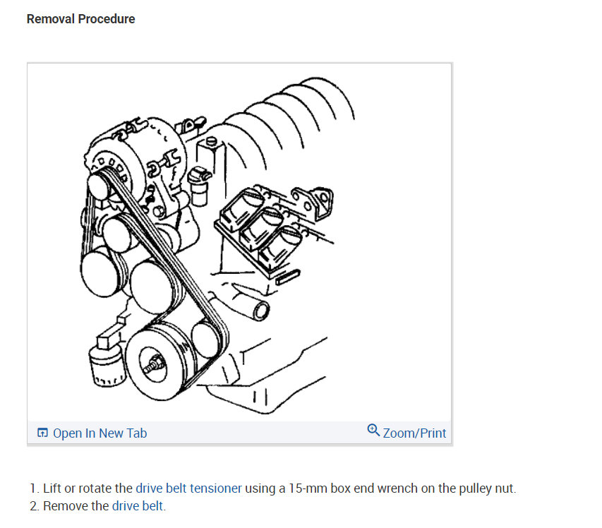

I've been getting a high pitched squeal/whistle sound when accelerating, it's not every time but only happens under acceleration and it doesn't matter if it's from a stand still or going from a low speed to a higher speed and stops as soon as I let off the gas pedal. It's definitely not any sort of belt squeal and I'm not having any idle issues. Could it possibly be a transmission issue?
Jun 21, 2021 at 2:46 PM
Good morning,

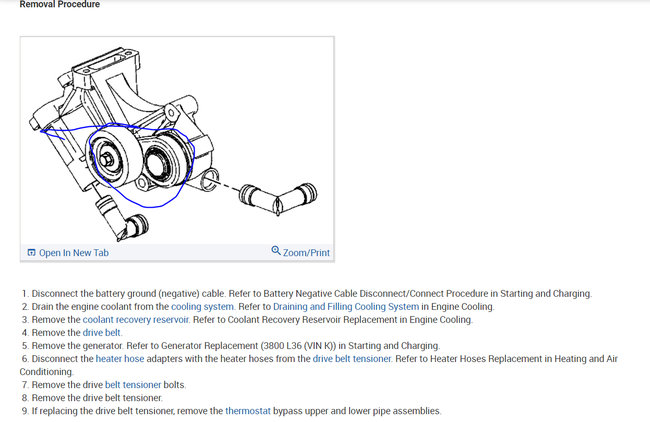

The most common failure for this is the serpentine belt tensioner.
https://www.2carpros.com/articles/car-squeaking-noise
I would remove the drive belt and then drive it and see if the noise is still there. That will confirm it.
https://www.2carpros.com/articles/serpentine-belt-tensioner-replacement
