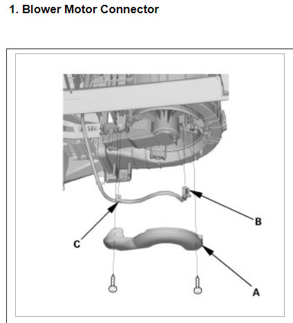

Recently I noticed my HVAC blower motor was quite a bit louder than normal. When I say louder, I mean making a roaring sort of noise as if a bearing was about to go. Thinking it was about to fail I replaced it with a new motor from CarQuest. (https://shop.advanceautoparts.com/p/carquest-blower-motor-76968/11001061-P?navigationPath=L1*14922%7CL2*15019%7CL3*15907).
This new motor does not have the roaring noise but it does have a high pitched buzz coming from it. The buzz is present at all fan speeds, but more pronounced when the fan is set at a higher speed.
The weather here has been below zero for days in a row, so I am wondering if the extreme cold is playing a role in this or not. Or perhaps I picked up a bad motor.
Should I try a new motor, maybe one directly from Honda, or is there some underlying issue that may be causing the noise?

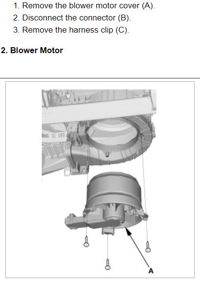

It does sounds like you have a defective blower motor but to be sure if you can take a quick video of the problem and upload it here at the site I can tell for sure.
Here is a guide and diagrams to install the blower correctly:
https://www.2carpros.com/articles/blower-fan-motor-works-on-high-speed-only
Here is the part from Honda:
https://www.amazon.com/Genuine-Honda-79305-TR3-A01-Blower-Sub-Assembly/dp/B00MPP7HAY/ref=sr_1_10?ie=UTF8&qid=1514917231&sr=8-10&keywords=2012+HONDA+CIVIC+blower+motor
Jan 2, 2018 at 10:21 AM
