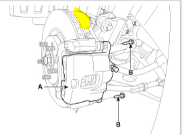

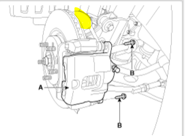

I do hear it. If it stops when you use the brakes or make a sharp turn, it could be a couple things. However, I need you to check something simple for me.
On the rear of the brake rotors is a dust shield. Check to see if there is anything wedged between it and the rotor. Also, make sure it isn't bent and touching or rusted and touching.
I attached a pic and highlighted the top of the dust shield. It does go around the rear of the rotor. Only the top can be seen in the pic.
Let me know what you find,
See pic below.
