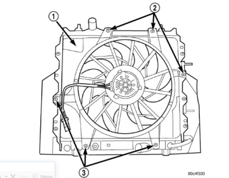

Freon was just charged two days ago. I think it might be the fan low speed relay switch because the is not running while the car is parked but does run while the car is moving.

Do you know which sensor is the low fan speed sensor? I can see two fan relay switches but I do not know which one is which.
Jun 25, 2018 at 7:45 AM

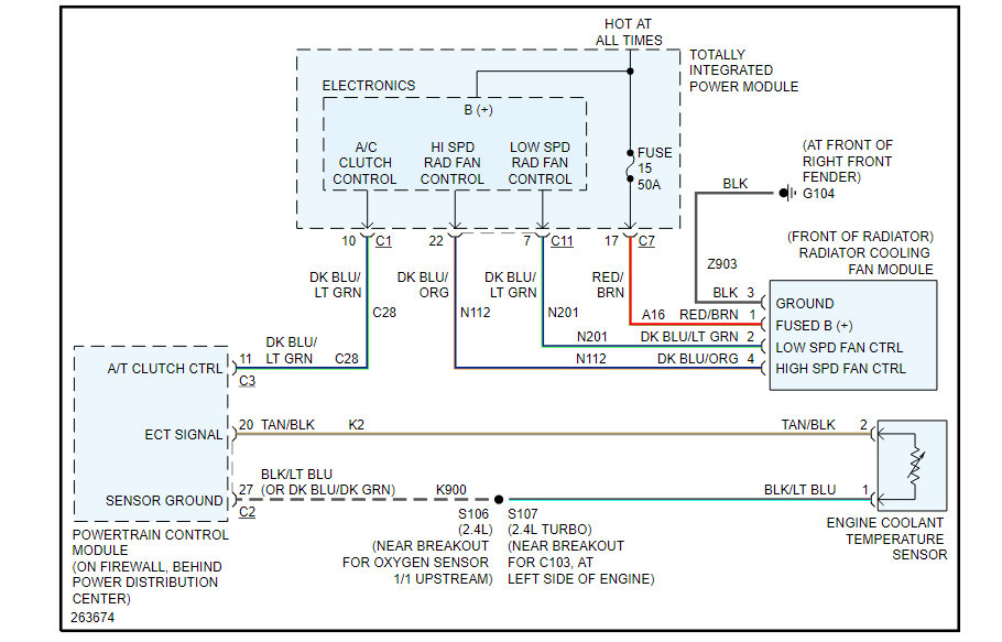

There are no relays that you can replace. The two relays are part of the totally integrated power module which is your fuse block. The only way to replace the relays is to replace the fuse block.
Editor's Note: This vehicle is not equipped with Cooling Fan Relays. The fan is controlled by the PCM via electronics integral to the Totally Integrated Power Module (TIPM). For more information, please refer to:
See: Radiator Cooling Fan > Electrical
See: Power and Ground Distribution > Electrical > Power Distribution
Jun 25, 2018 at 7:52 AM

Oh okay. Well one of the relays that I can see next to the fan is the A/C clutch relay switch. I am not sure what the other one is. The guy at the auto parts store not that they are mechanics by any means said that replace that switch could fix it. What do you think?

The fans have two modes, a slow and fast one. The fast mode is when both fans are running and you can actually hear them running from outside of the car. Anytime the A/C is on, the fans should be running. Hope this helps.
Jun 25, 2018 at 3:33 PM
You are right. They are parts salesman and they want you to buy something.
No, the controls are inside the fuse box, not external.
