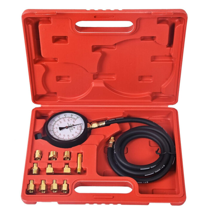

First, I would suggest checking the engine oil pressure using a mechanical oil pressure gauge. See image 1.

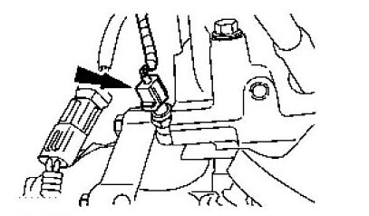

It is best to remove the oil pressure sensor, located on the right rear of the engine.
Removal and Installation:
Disconnect the battery ground cable. Disconnect the engine control sensor wiring from the oil pressure sensor. Image 2
Remove the oil pressure sensor.
Screw in the oil pressure gauge and start engine.
Let it get to operating temperature. The oil pressure will be high with cold engine
Oil pressure at idle
12.5-15 Psi
At 2500 rpm 40-60 Psi

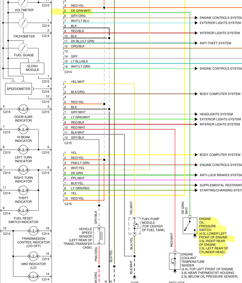

If the readings are correct, then you know that the oil pump is in order, and you might have a possible faulty sender unit or a possible wiring issue between the sender unit and the instrument cluster.
Pin out at sender to cluster, see image 3.
Pin 1, dark green, white wire to cluster pin 5 on connector C214.
Suggest checking this wire pin to pin for a possible resistance issue.
Expect to see less than 2ohm pin to pin.
