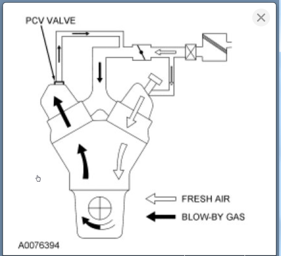

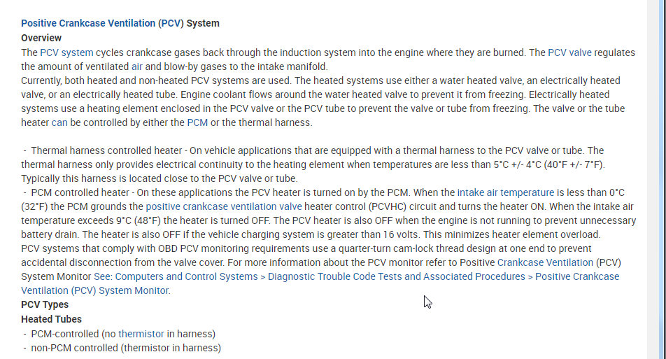

We want to check the PCV and make sure this is not clogged. While I don't think this is going to solve the issue it will be a good indication as to this is the issue. I attached the info below on this for your review.
Feb 19, 2021 at 6:58 PM
