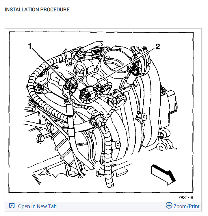

First you need to charge the battery back up, here is a guide to help:
https://www.2carpros.com/articles/how-to-charge-your-car-battery

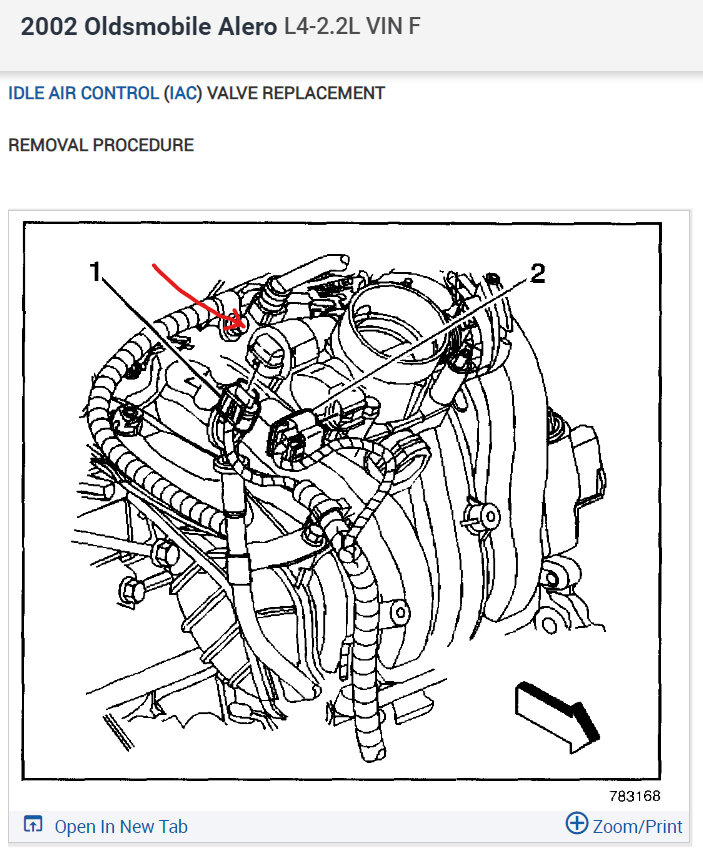

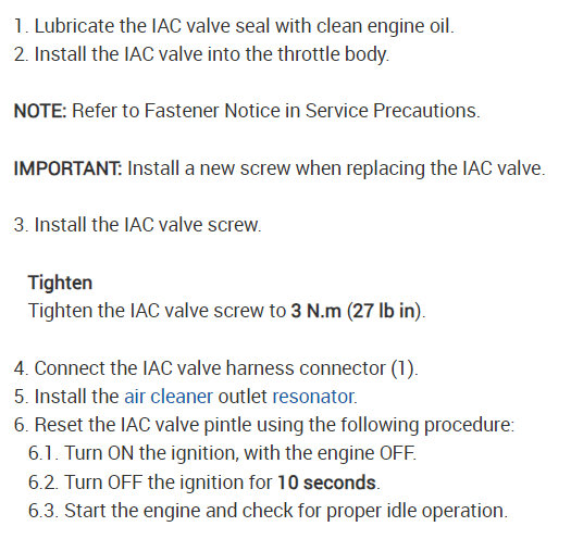

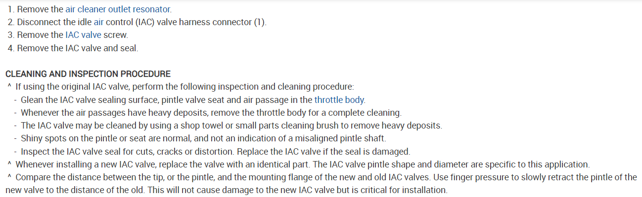

After that try to start the engine by holding your foot on the gas pedal slightly, if the engine starts it sounds like the IAC valve needs to be replaced. I would service the throttle bore at the same time.
This guide can help:
Check out the images (below). Please upload videos in your response of any problems so we can see what to help you with.
