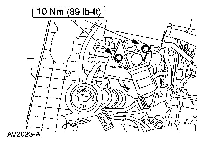

The Idle air control valve could be fualty id say check that ..note" this procedure works about 60 percent of the time .. it can be cleaned out with throttle body cleaner and a small tooth brush dont use a metal bristle brush it will damag it ..if you get it really clean it will slide freely again its probably stuck in the open positiion once done cleaning it when your sure youve freed it up it can be tested woth a 12volt source or if youre confident just put it back in and try starting it ..but when energized you should see it fully functional again and once reassembled it it should return to a perfect idle again..also check the gasket and be carful not to damage the gasket if it doesnt seal properly the idle will jump back up ..if you clean it and you dont get good results replace idle air ontrol valve with a new one ...theyre pretty reasonably priced and can be perchased at most auto parts stores .ive added a diagram of what it looks like on the engine please click the image below to expand it for better viewing
good luck i hope this helps

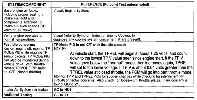

Here some charts to help ..also the pcv valve is important just spray it out with carb cleaner or just replace it might be gummed up its works along side the iac and the map and maf and tps sensors to control the mixture ratios to control the idle ..also check any vacuum lines down at the transmission if equipt and i know you replaced the intake but id double check there for leaks while running spay cleaner around all joins in these areas to see if idle changes also the base gasket for the throttle body and surrounding boots hoses evan though you've checked already only takes a min .also try disconnecting the iac and or throttle cable if equipt to see if the idle drops ..best of luck ..

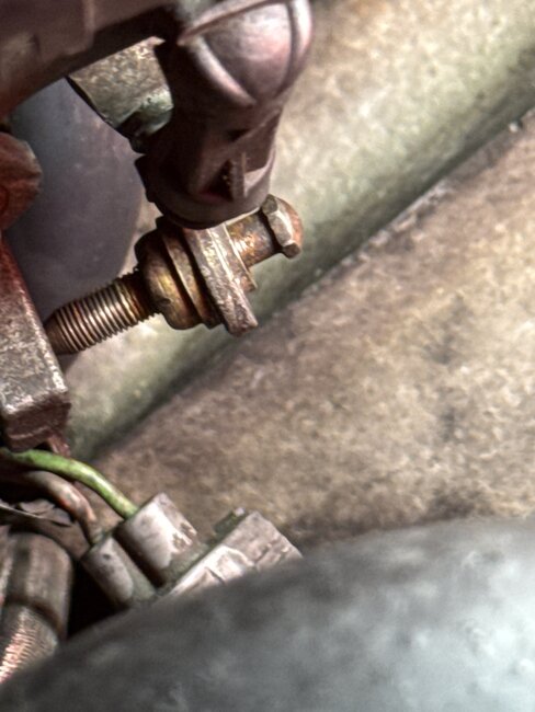

CHARCHAR22
  • 10 POSTS
Here's the screw an some live data streams
Aug 31, 2025 at 6:10 PM
MECHTRIX
  • 393 POSTS
Yeah just get a wrench that fits that screw start the car let it warm for 5 to 10 mins then turn the screw left counter clockwise slowly and listen to the idle youl notice it drop if you dont keep turnin it slowly keep turning it slowly till the idle drops to 700 rpm watching the gage and stop at 700 turn the engine off wait a few mins start it again it should run a bit fast the colder the engine is on start up but as It warms up it should settle right back to the original speed where you leaft at 700rpm just try it only should take maybe about 3 mins or less its best to have a digital timing light for this but you can still slow it down to a satisfactory idle if you don't have one and go back to it later and just dial it in when you have access to one ..good luck let me
