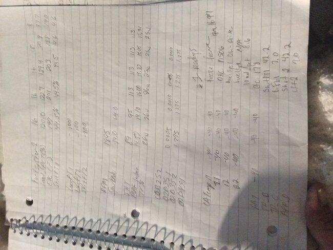

I've been having issues with a high idle I've recently changed valve cover gaskets intake manifold gaskets mass air flow sensor iac valve cleaned throttle body replaced spark plugs n wires coil pack checked for vacuum leaks,the only thing I can think is that the throttle screw is not in right position any way you could help me out on where it's supposed to be set at factory the engine is 4.0l ohv 2000 Ford explorer xls vin x these are some results from my OBD2 scanner live data

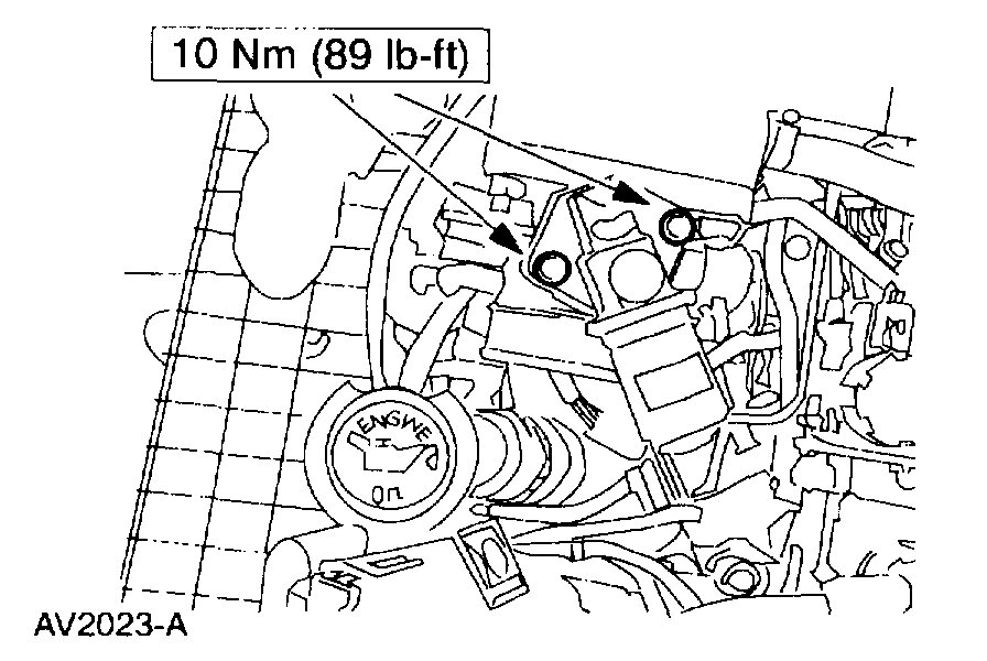

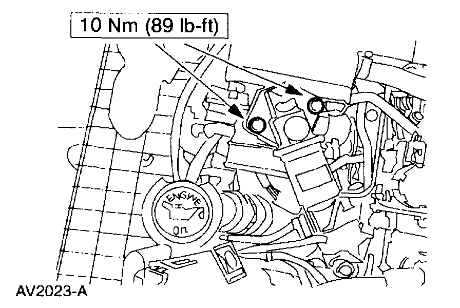

The Idle air control valve could be fualty id say check that ..note" this procedure works about 60 percent of the time .. it can be cleaned out with throttle body cleaner and a small tooth brush dont use a metal bristle brush it will damag it ..if you get it really clean it will slide freely again its probably stuck in the open positiion once done cleaning it when your sure youve freed it up it can be tested woth a 12volt source or if youre confident just put it back in and try starting it ..but when energized you should see it fully functional again and once reassembled it it should return to a perfect idle again..also check the gasket and be carful not to damage the gasket if it doesnt seal properly the idle will jump back up ..if you clean it and you dont get good results replace idle air ontrol valve with a new one ...theyre pretty reasonably priced and can be perchased at most auto parts stores .ive added a diagram of what it looks like on the engine please click the image below to expand it for better viewing
good luck i hope this helps

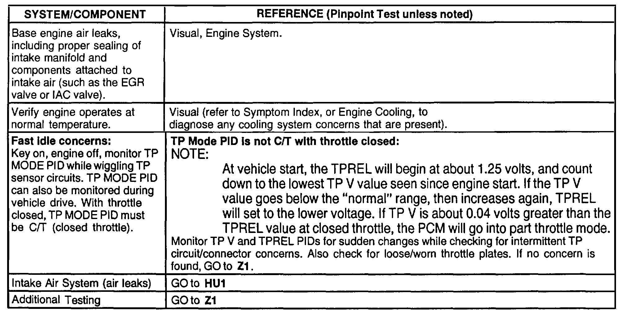

Here some charts to help ..also the pcv valve is important just spray it out with carb cleaner or just replace it might be gummed up its works along side the iac and the map and maf and tps sensors to control the mixture ratios to control the idle ..also check any vacuum lines down at the transmission if equipt and i know you replaced the intake but id double check there for leaks while running spay cleaner around all joins in these areas to see if idle changes also the base gasket for the throttle body and surrounding boots hoses evan though you've checked already only takes a min .also try disconnecting the iac and or throttle cable if equipt to see if the idle drops ..best of luck ..

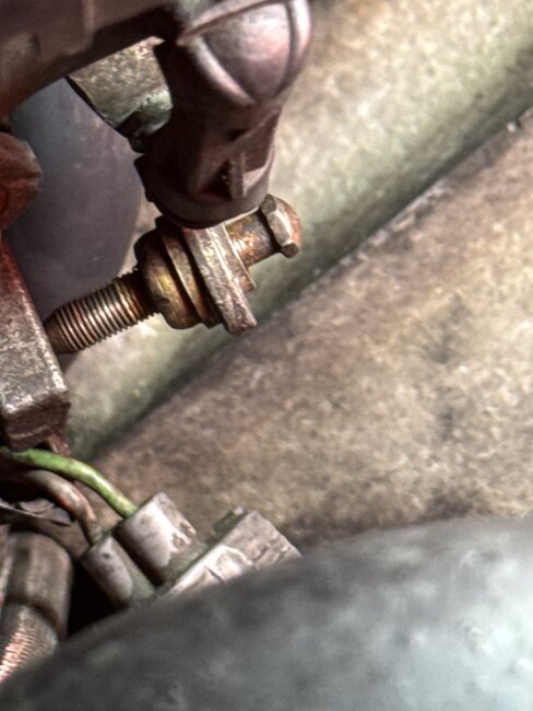

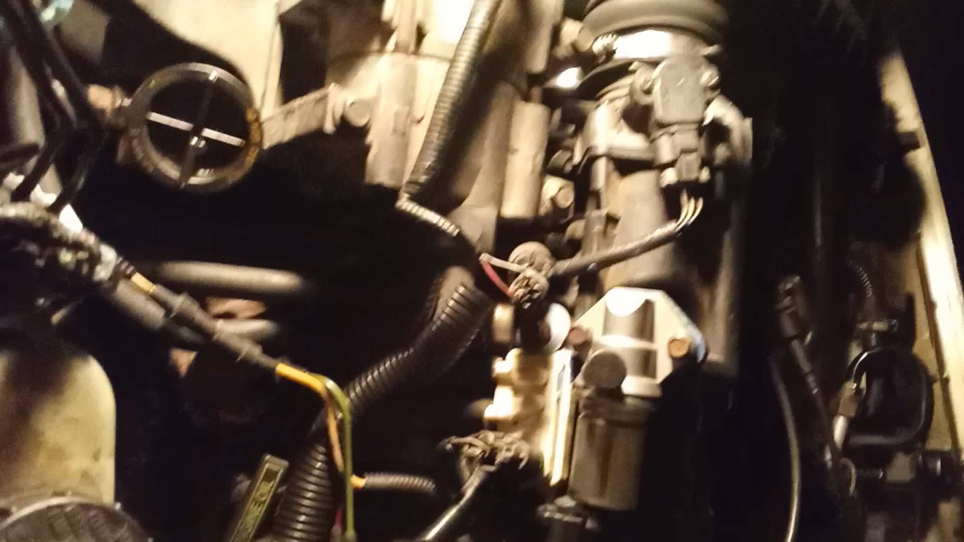

Thanks for the information I did replace pcv but did not check brake booster but my brakes do feel like there losing pressure so I'll look into that thanks for the help but like I mentioned in previous post the throttle body screw has been tampered with do you think that's an issue an do you know where it's exactly supposed to be set at

The screw definately can be the issiue if you have one run the engine amd if you have one hook up a digital timing light with an rpm gage in it .and adjust it while running in real time looking at the gage and stop when you get the idle down to the desired rpm for best idle..or just ajust it down to where it sounds ok for now and use a rpm gage later when you have one around that said the factory best idle speed for this car us 700 rpm ... that is if you have a adjustment screw many cars do not they bagan to faze them out but it being a 2000 model it probably still did ..unless somebody put it on there ...hence maybe why it looks like its been tampered with right ? Can you post a photo ?
becuase If its found that someone has tried to install it where it doesn't belong and it all boogered up change the throttle body its ruined ...but please post a photo of the screw in question thanks and dont give up you half way home ..good luck

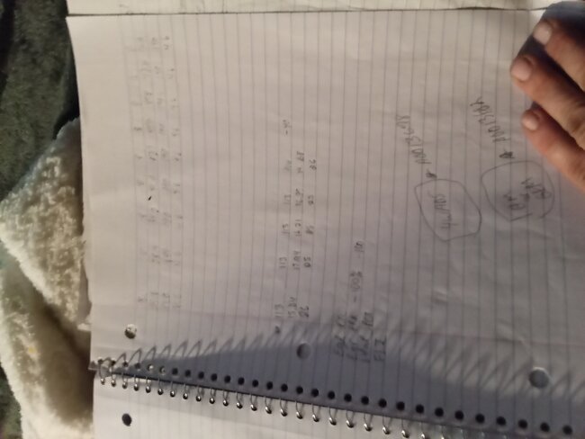

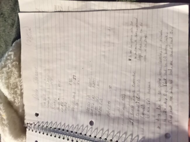

Here's the screw an some live data streams

Yeah just get a wrench that fits that screw start the car let it warm for 5 to 10 mins then turn the screw left counter clockwise slowly and listen to the idle youl notice it drop if you dont keep turnin it slowly keep turning it slowly till the idle drops to 700 rpm watching the gage and stop at 700 turn the engine off wait a few mins start it again it should run a bit fast the colder the engine is on start up but as It warms up it should settle right back to the original speed where you leaft at 700rpm just try it only should take maybe about 3 mins or less its best to have a digital timing light for this but you can still slow it down to a satisfactory idle if you don't have one and go back to it later and just dial it in when you have access to one ..good luck let me

So what was your opinion on the numbers from the live data streams

I couldn't make out what they were for but its not that complicated I'll look at them again but you've already done the more important things if you're able to get the idle back down you're pretty much gonna be done it might be just adjusting that screw by now we'll see but yeah let's try that first do you have access to a timing light with rpm guage ? If not no worries you can still turn it down won't hurt anything but i do have one more question have you been driving the car ? How does it drive evan with the high idle other than that does it drive normally ? If it does just adjust the idle like I described to 700 rpm and it should be fine ..should stay that way since it seems like you've done everything so yeah Check that next and.. youre doing a great job BTW.. good luck let me know

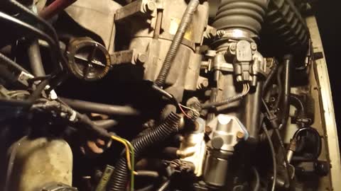

Here a video

It sounds like it still has exhuast leaks also possibly a vacuum leak in the video but did you
Check the 3 things ? also it should be timed with a digital timing light with an rpm function
According to the video .. if you do the things we discuss earlier it will improve let us know good luck

Okay thank you yes I did but I cannot find the leak so I'm gonna have to get a tester then I'll let ya know from there thanks for all the help
