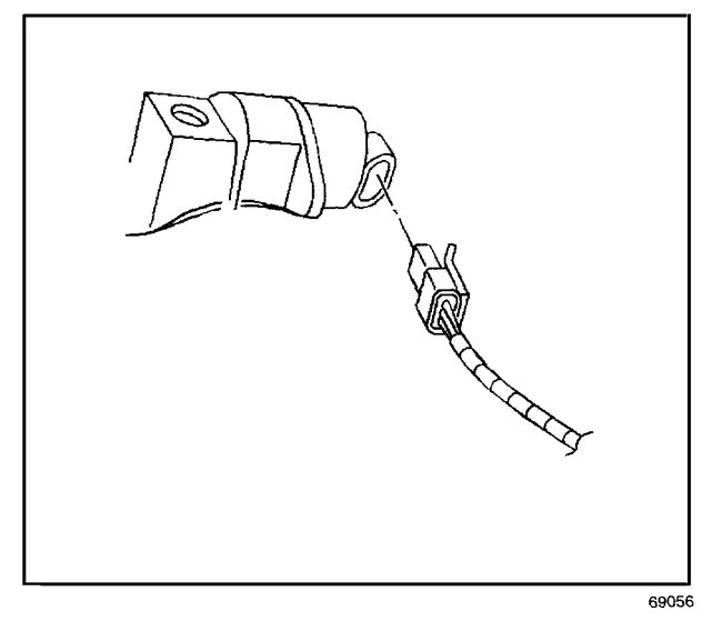

Hello, I am new here. I drive car for about an hour and it ran perfect. I get home and park for thirty minutes and get back in it and it is revving at 3,000 rpm's. I put in gear it goes down but runs with out accelerating at fifty mph. There are no codes on dash. I replaced the idle air control and it is still revving high, but not driving by itself. Please help!

If the IAC is new and there are no codes, the first thing I want you to check for is an engine vacuum leak. If too much air gets into the combustion chamber, it can cause a rough or high idle. Here is a link that describes how to check for a leak.

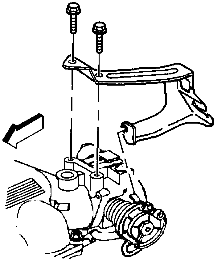

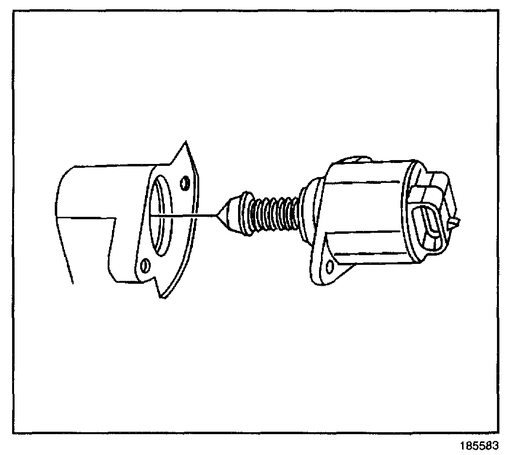

Also, here are the directions from alldata for replacing the IAC. Make sure you did it correctly. The attached pictures correlate with these directions. Also, at the end of the directions, you will see a simple relearn procedure that needs done so the computer resets and calibrates the new IAC.
_______________________________________
IDLE AIR CONTROL (IAC) VALVE REPLACEMENT
REMOVAL PROCEDURE

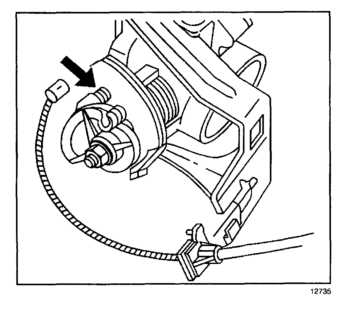

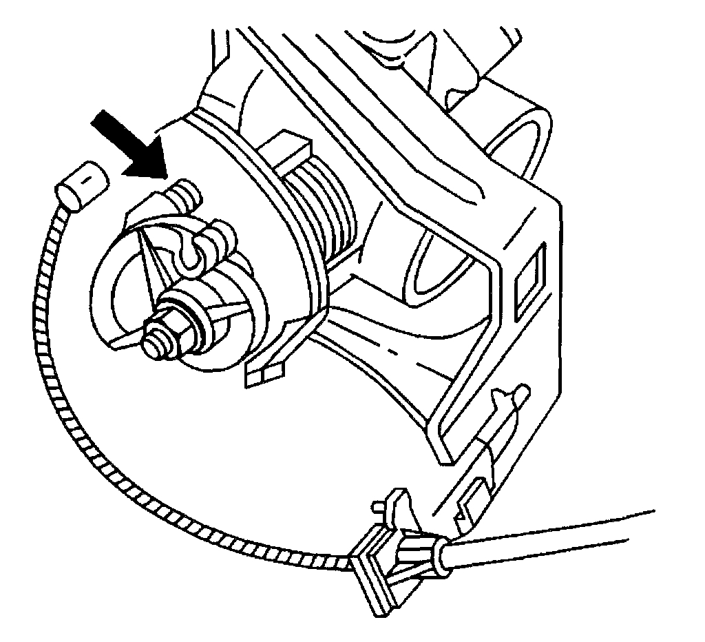

1. Remove the throttle control cable bracket from the throttle body.
2. Remove the canister purge valve.

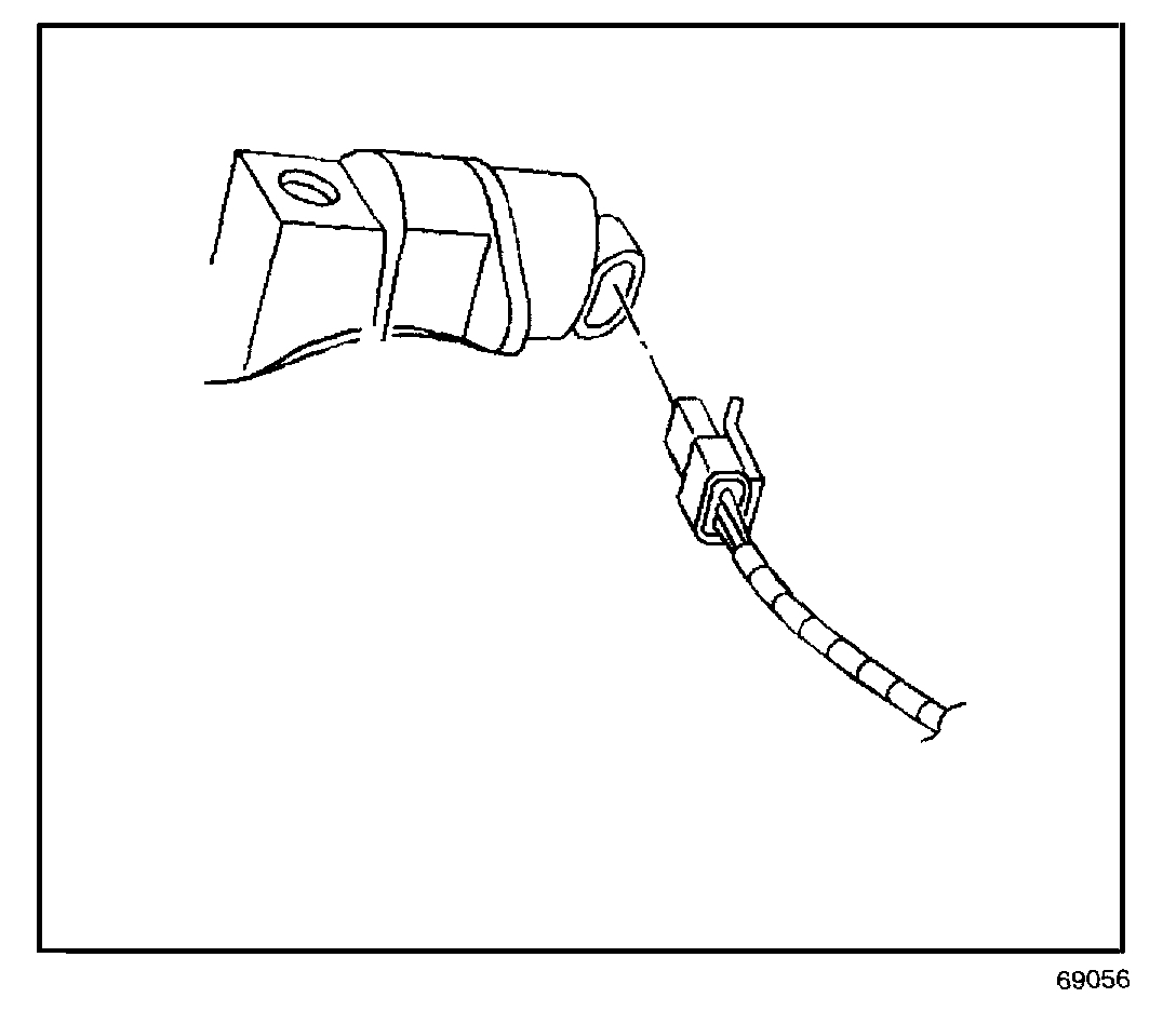

3. Disconnect the IAC electrical connector.

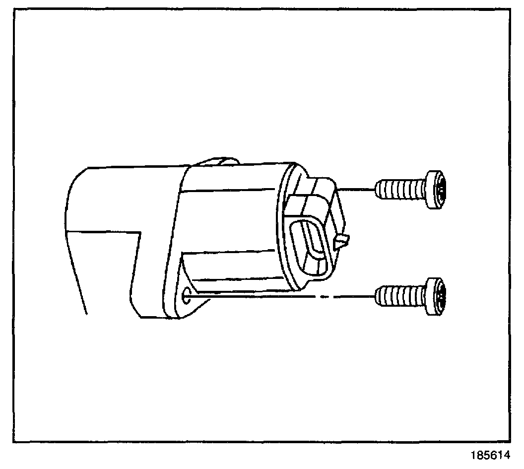

4. Remove the idle air control valve (2) attaching screws.
5. Remove the idle air control valve.
6. Remove the idle air control valve O-ring.
INSTALLATION PROCEDURE

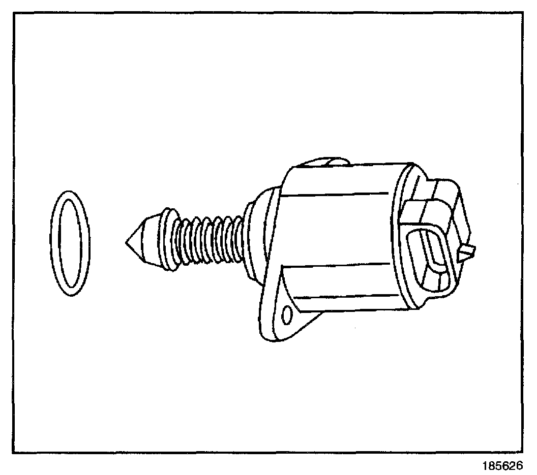

NOTE: The IAC valve may be damaged if installed with the cone (pintle) extended more than 28 mm (1-1/8 in). Measure the distance that the valve is extended before installing a new valve. The distance from the idle air control valve motor housing to the end of the idle air control valve pintle should be less than 28 mm (1-1/8 in). Manually compress the pintle until the extension is less than 28 mm (1-1/8 in).
1. Install the new idle air control O-ring.
2. Install the idle air control valve into the throttle body.
NOTE: Refer to Fastener Notice in Service Precautions.
3. Install the idle air control valve attaching screws.
Tighten
Tighten the screws to 3 N.m (27 lb in).

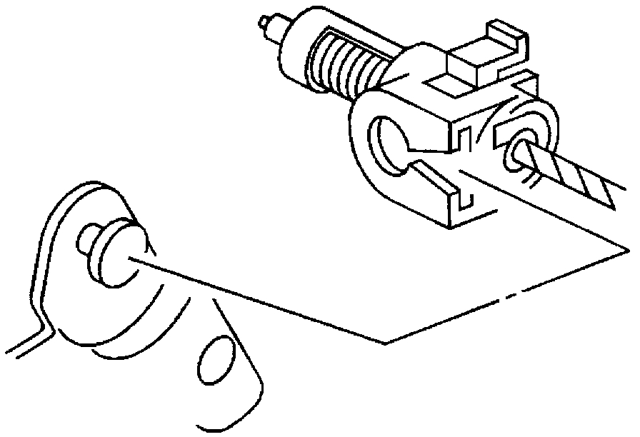

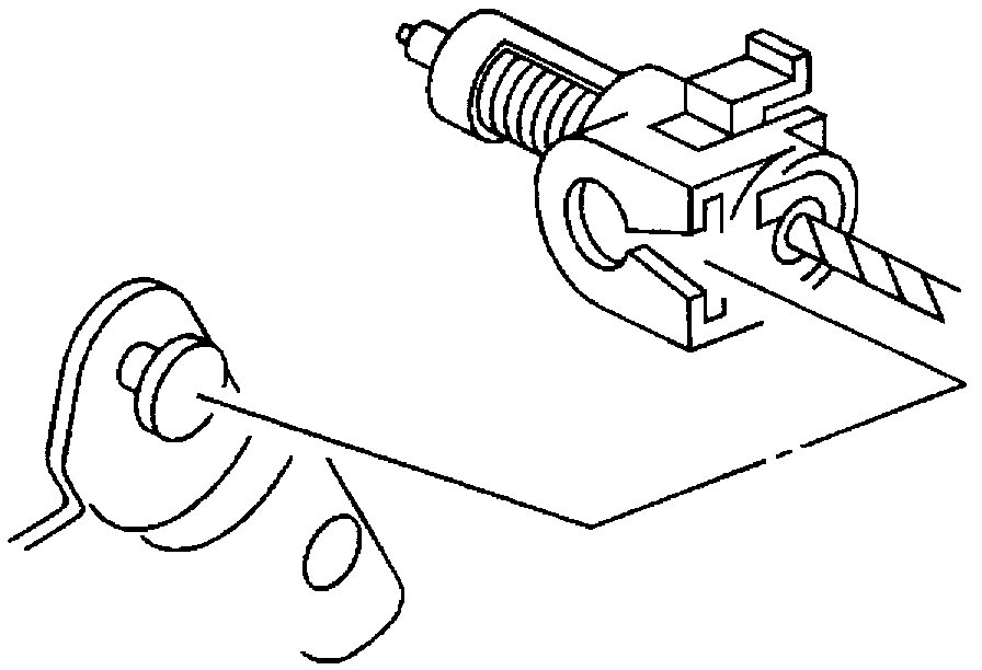

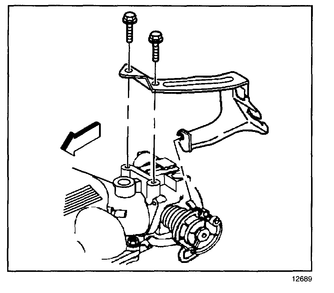

Also, make sure the throttle cable isn't bad, frayed, sticking and there is no damage to the throttle cable bracket. Here are directions for replacement if needed. Starting with picture 9, all pics correlate with these directions. Also, when the throttle is released, make sure the throttle plate is fully closing.

2. Disconnect the accelerator cable from throttle body.
3. Depress the tangs and remove the accelerator cable from accelerator cable bracket.

6. Remove the nuts and bolts holding the accelerator cable bracket to the throttle body.
7. Remove the accelerator cable bracket.

4. Connect the accelerator cable into accelerator cable bracket.
5. Connect the accelerator cable into throttle body.

Let me know if this helps or if you have other questions. Note: Make sure the o-ring for the IAC was not damaged when you replaced the part, and there is no carbon built up in the throttle body where the IAC mounts.
