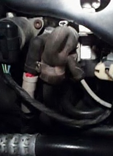

I think I just found the prob. In the pic. Look at the rubber 90 it is sucked in when the car is running turn car off and it goes back to norm. What do I call it when I go to the parts store?
Monday, January 3rd, 2011 AT 1:25 AM
  • 109,885 POSTS
I can't tell where I'm looking on the engine. Where is that located?
Monday, January 3rd, 2011 AT 12:32 PM
JKIFER632
  • 5 POSTS
Its on the throttle body next to the iac
