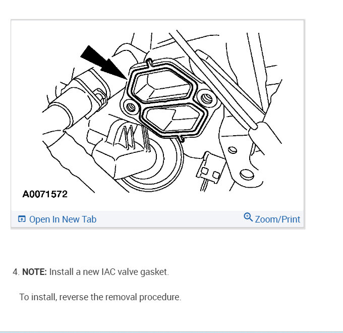

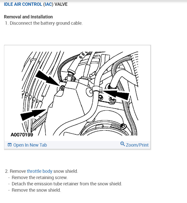

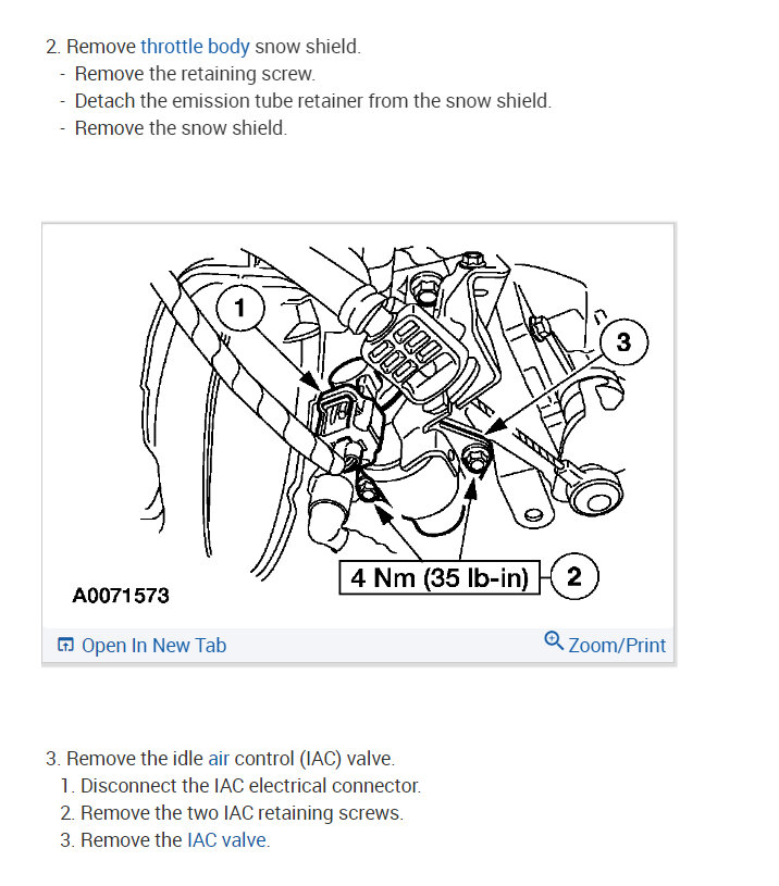

recently repaired the starter motor on my 2005 Ford Bantam Rocam 1.3i [replaced brushes on starter motor]. A day or two later I noticed idle was sitting at 1,400 RPMs. Suspect a couple of things but not sure where to locate [Google not much help]. Looking for the location of Idle Control Valve to assess. Still need to do a vacuum leak check [which I don't know how to do or where to start]. any other things I should check for? Thanks in advance

The idle air control valve is mounted on the throttle body. I have left instructions in the images below. Also, here are two guides and can help us fix the problem. Use the first guide when the engine is cold only.
and
https://www.2carpros.com/articles/engine-idles-too-high
