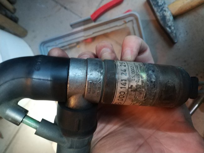

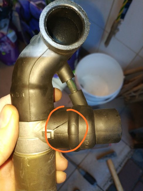

Hello, I have an issue with a high (around 1,000 rpm's) idle when (and only then) the engine is warm and it is set on P or N. When put on D it goes down to around 700. I have inspected the vacuum and the secondary air hoses. With one exception (I put a picture of the idle control valve hose crack for you to verify if that could cause such symptoms) they all look decent.
Would you have any advice?

The idle air control valve is electric and not vacuum actuated. The picture didn't come through, but if you have a crack in any of the vacuum hoses, it will cause problems. Here is a test for checking for vacuum leaks:

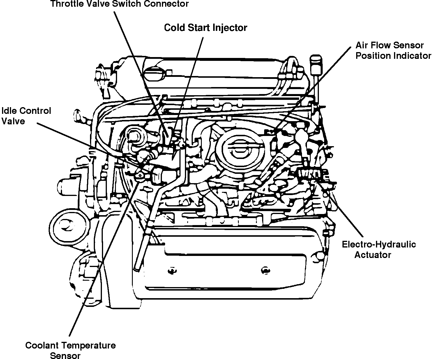

I attached a picture of the IAC location. Is that the component you are referring to?

Thanks for your answer. I have put the pictures of the idle control valve with a cracked hose I mentioned before. I have already ordered a new hose as well as a carburetor cleaner to clean some dirt I noticed in the valve. Do you think this might help?

I do feel that will help. Especially if the IAC is dirty. Be careful what you spray with the brake cleaner. It is very aggressive.
