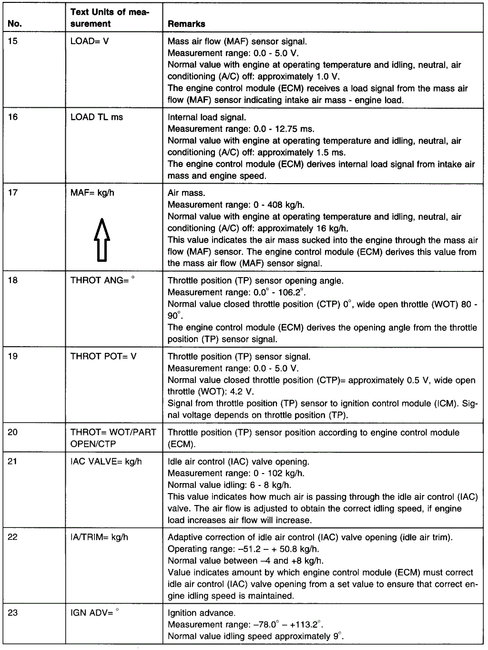

So, bought this car recently. Been going down the line fixing everything. Started with an audible vacuum leak at the intake hose boots, loping high idle issue, and a cylinder one misfire. Smoke tested and tested various components, then replaced the intake manifold gasket, the intake boots, cracked oil trap, spark plugs, coil wires, idle air control valve, some random cracked vacuum hoses, and the second stage ignition module. I still have a miss, i need to finish replacing the last few coil wires. But my biggest issue is I still have a 1250 rpm's idle in park when warmed up, idle starts around 950 rpm's cold. It also wont hold an rpm with the gas pedal, if you push the throttle down slightly the rpm's go to over 4000 rpm's within a few seconds, though the throttle position sensor reads only twelve percent. No check engine codes. And I got all the monitors to run. I have adjusted the throttle closed, throttle body is clean, smoke tested engine no leaks. I have tested the throttle position sensor, it is at .55 volts closed and 4.3 volts open, which is a bit off on the full open value but would not explain my idle. The absolute throttle position reads 9.8% at idle. Fuel trim always reads within a few percent of zero. I am just stumped. I am leaning towards the MAP sensor because the numbers do not add up, but I' am stumped on how to test it currently, had to call Volvo to even find it because it does not run off vacuum? My vacuum gauge reads twenty inches of mercury at idle off the manifold, i ran some of the normal vacuum gauge tests, all normal. Map sensor reads thirteen to sixteen inches on my scanner, I am at sea level.

I dont have a resistance spec for that. Just what it needs to read at idle. Have you checked your throttle for leakage also? Spray some carb cleaner around it to see if the idle drops down. Also try doing a soft reset by disconnecting the battery terminals and touching the leads together for 15 minutes.

Just for argument's sake, I tried again with the brake cleaner. still had some dirt around anyhow. cleaned it off, then 15 seconds later my idle went down to 700 Rpms and stayed there for well over 5 seconds. it was odd, idled lower like it should. I then used an entire can of brake cleaner trying to replicate it but I was unsuccessful. Also, Maf sensor reads 1.24v at idle but should be at 1v. Also that chart you sent says maf should read 16 kgh, I have about a pound per minute reading on my scanner which equals 60lb hr or 27 kgh according to my math. So I'm running about roughly double the air I should through my maf? But idle is high, so that value is skewed. But still. Soft reset unsuccessful as well. I'm not sure how to test most of the other items on that chart as my scanner doesn't show values for them.

Update, I finished my coil wires after my cars idle shot up to 1500-1900 rpms. My cat started to glow a bit. I still have a miss/stumble but my knock sensors dont register it anymore. Idle went back to previous amount but it still has a high metered flow reading on the maf sensor and the iacv is closed fully. Acts like a vacuum leak, but can't find one, and the extra air is metered, not unmetered. Is the computer changing the maf sensor values?

The reading could be caused by the high idle. Kinda odd the idle did actually go down for a bit? It would sound like you have a vacuum leak somewhere? Also what brand idle air control valve did you install?

I have verified the valve is fully closed at idle. It's a Volvo iacv, but it's rebuilt. It was running so rich the cat couldn't keep up and the rear 02 started reading like the front. I removed a huge 2 inch air hose from the intake and it still ran. I could feel pressure pulsing through the intake tube. The idle got so bad i removed the entire manifold, I found a large piece of debris stuck in one of the valves on cylinder 1. I tried removing it with a magnet, but it was non magnetic, then tweezers but eventually it fell in. I'm not sure how that can make it run rich, but we will see.
