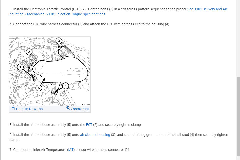

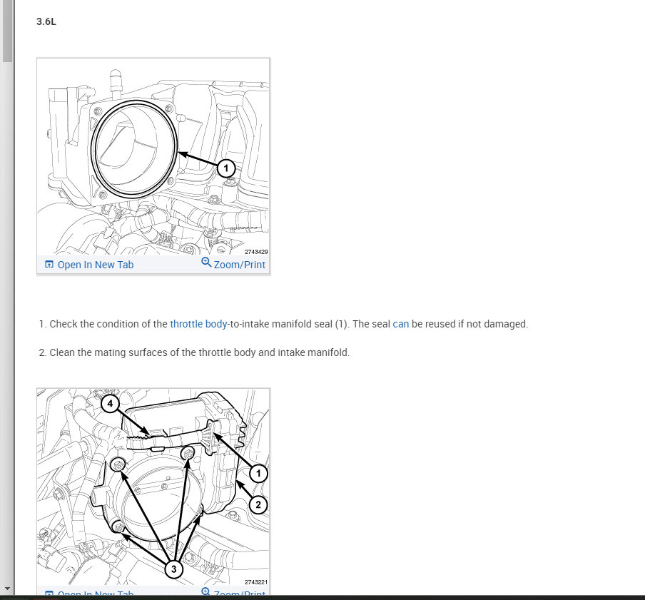

Okay. That is great info. This vehicle has an electronic throttle control so this could just be a throttle body or something more serious.
Are there any codes?
I attached the info on the throttle body. I would inspect it and see if it is dirty. With it having a turbo on it now you are forcing more air so it could be dirty.
