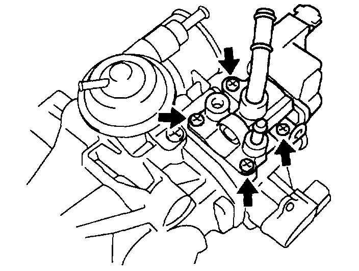

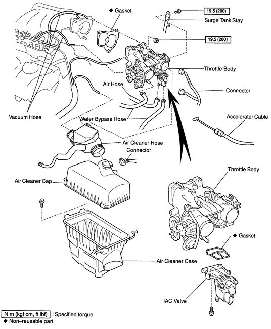

As mentioned, I worry when aftermarket parts are used for specific types of repairs. Tell me this. When you replaced it, was everything where it mounts clean and carbon free? Also, have you tried cleaning the throttle body? When you had the throttle body off to replace the IAC, are you certain it was resealed properly and there are no vacuum leaks?
Here are the directions specific to your vehicle for replacing the IAC. Take a look through them to make sure everything was done.
1999 Lexus Truck RX 300 AWD V6-3.0L (1MZ-FE)
Removal and Installation
Vehicle Powertrain Management Fuel Delivery and Air Induction Idle Speed/Throttle Actuator - Electronic Service and Repair Procedures Removal and Installation
REMOVAL AND INSTALLATION
pic 1
COMPONENTS
REMOVAL
1. REMOVE THROTTLE BODY
pic 2
2. REMOVE IAC VALVE
Remove the 4 screws, IAC valve and gasket.
HINT: At the time of installation, please refer to the following items. Place a new gasket on the throttle body.
INSTALLATION
Installation is in the reverse order of removal.
