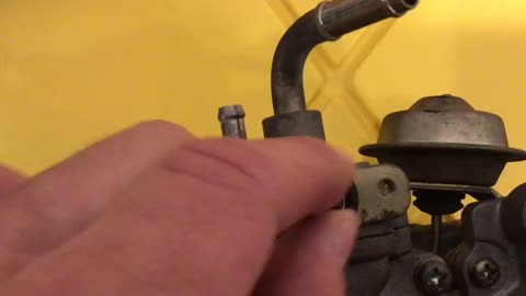

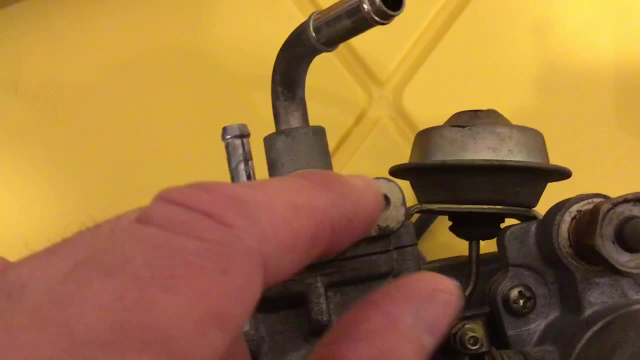

DRAKMNSTR
Hi JISOO1, thank you for your reply. I went back today to Everything out. I even pulled the electromagnetic piece out. Check engine came on as expected. Car started and Rpm's were higher than ever. IACV moving freely with no problem. I may purchase a real authentic IACV but I checked it before I put it in. SEEMS exact but of course I am no expert. I will show three videos. Thanks for looking.

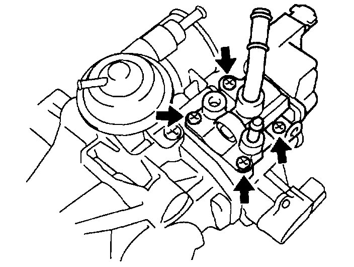

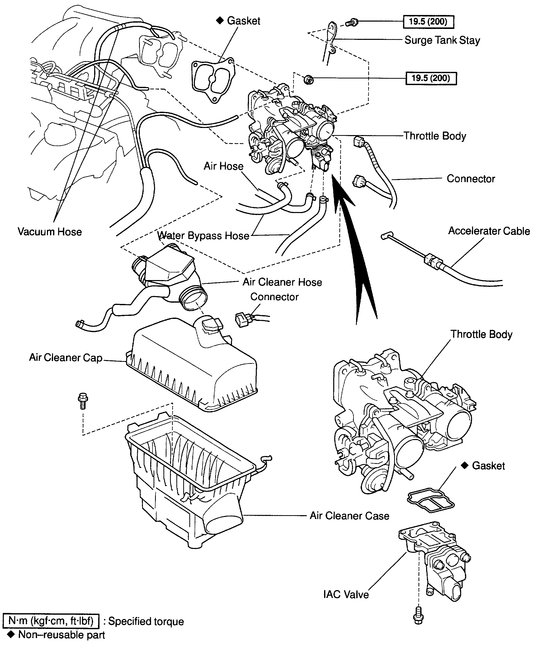

As mentioned, I worry when aftermarket parts are used for specific types of repairs. Tell me this. When you replaced it, was everything where it mounts clean and carbon free? Also, have you tried cleaning the throttle body? When you had the throttle body off to replace the IAC, are you certain it was resealed properly and there are no vacuum leaks?
Here are the directions specific to your vehicle for replacing the IAC. Take a look through them to make sure everything was done.
1999 Lexus Truck RX 300 AWD V6-3.0L (1MZ-FE)
Removal and Installation
Vehicle Powertrain Management Fuel Delivery and Air Induction Idle Speed/Throttle Actuator - Electronic Service and Repair Procedures Removal and Installation
REMOVAL AND INSTALLATION
pic 1
COMPONENTS
REMOVAL
1. REMOVE THROTTLE BODY
pic 2
2. REMOVE IAC VALVE
Remove the 4 screws, IAC valve and gasket.
HINT: At the time of installation, please refer to the following items. Place a new gasket on the throttle body.
INSTALLATION
Installation is in the reverse order of removal.

Hi Joe,
I purchased an original OEM and a throttle body that had only 41000 miles on it. The price was to good to pass up. I removed the bLack piece to clean because I knew it may have a lot of carbon and possibly may be sticking. It was. After replacing the throttle body, Presto! Car idles fine. You were correct about the low cost parts. OEM will never let you down!
I attached a short video. I did clean it with throttle body cleaner. All good. Thank you!
