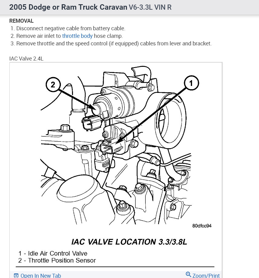

When first starting and engine is cool the throttle will drop a bit but immediately raises to 2,100 RPMs. It runs high in park, and while in gear.

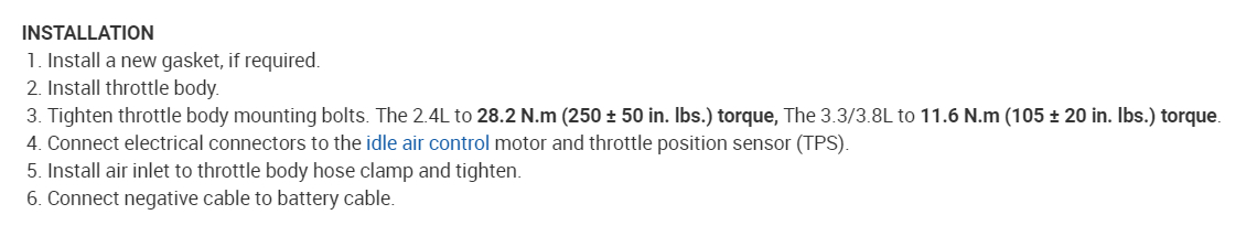

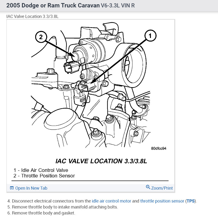

This can be because of two different factors either you have a vacuum leak because the sealing gasket got damaged when you reassembled the throttle body back into the engine, here, or the engine's computer needs to relearn which can take a day or two. Here is a guide to help you check for leaks and how to replace the gasket for the throttle body in the diagrams below:
and
https://youtu.be/Ui8zhMLp5EM
If everything checks out just drive the van for a few days and it should relearn the idle speed. Also are there any check engine lights on?
