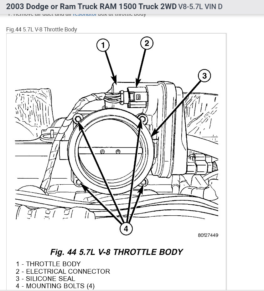

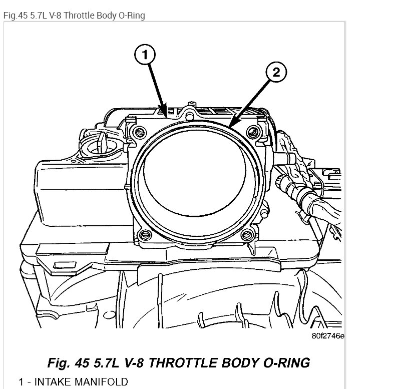

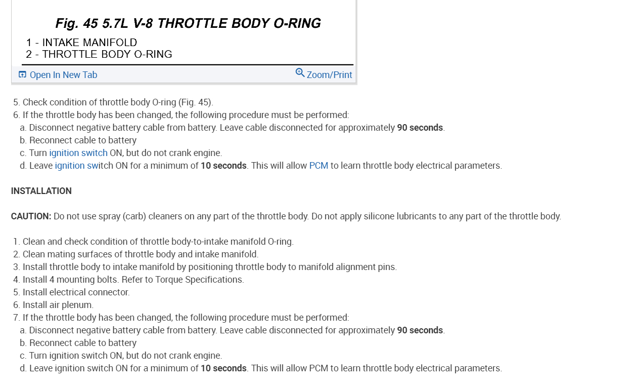

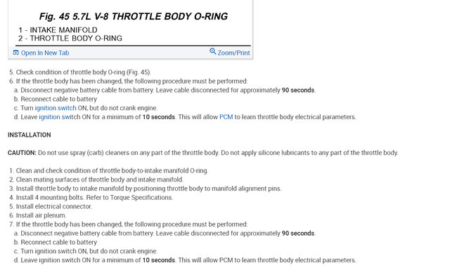

If no leaks are found, let's service the throttle body which the IAC motor is internal, check out this guide and look at the images below to show you how on your truck:

Check out the images (below). Please let us know what you find. We are interested to see what it is.
