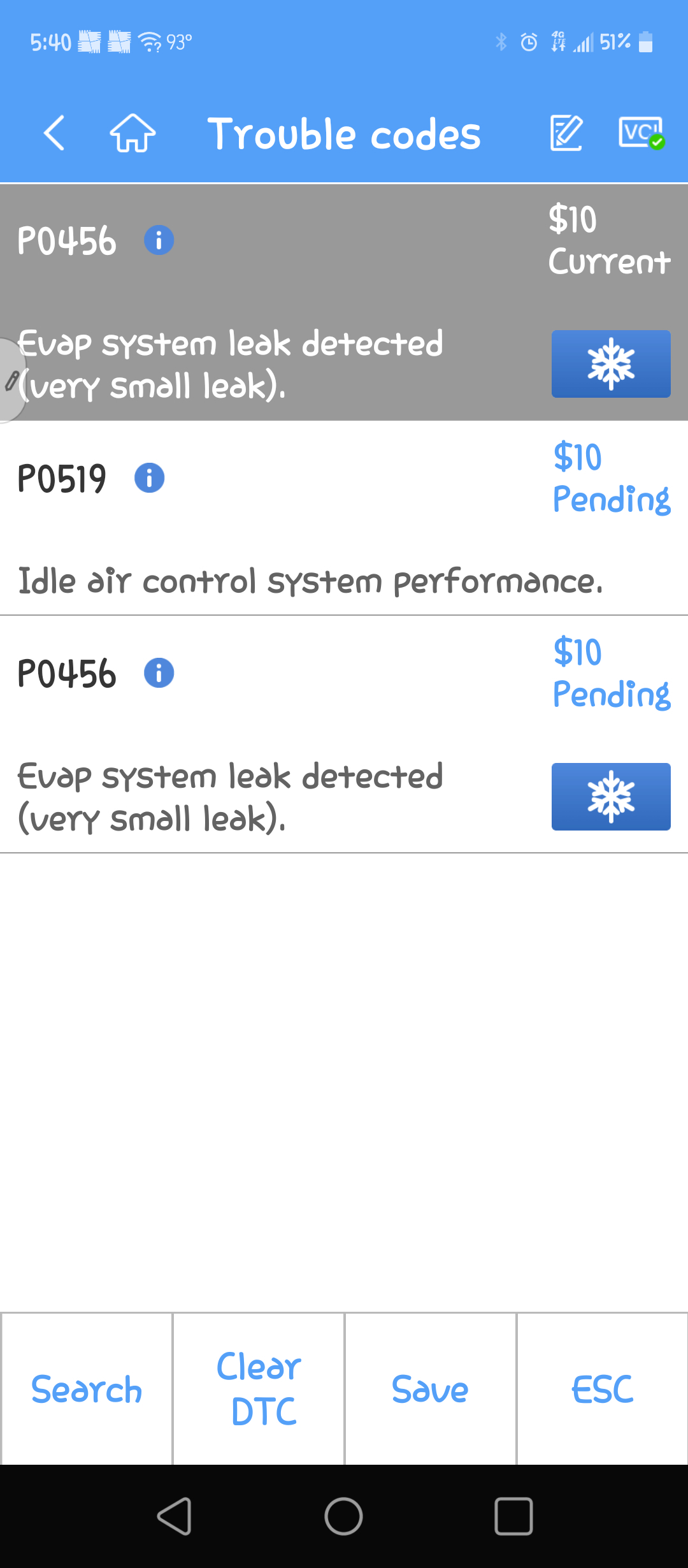

These are the codes I got today it just took a little while after I installed the injector because I had to reset the computer.

The two codes are related to two different things. The evap leak (small leak) can be something as simple as a bad fuel cap. Remove the cap and make sure there is no rust or corrosion around the top of the filler neck. If that all looks good and the cap is good, I recommend having the EVAP system smoke tested.
Basically, smoke is injected into the EVAP system at a very low pressure. If there is a leak, the smoke will come out at that point. I suggest this because if there is a crack in a hose or something other that is similar, it will be very difficult to find.
The idea that the EVAP code could cause a "small" vacuum leak could cause an idle issue.

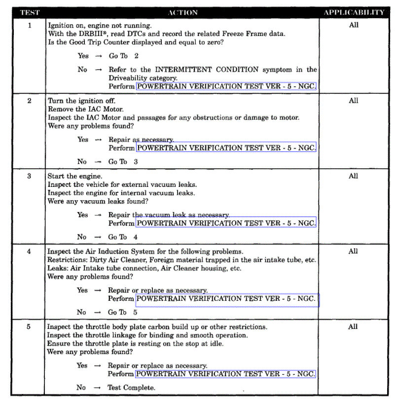

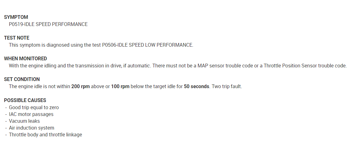

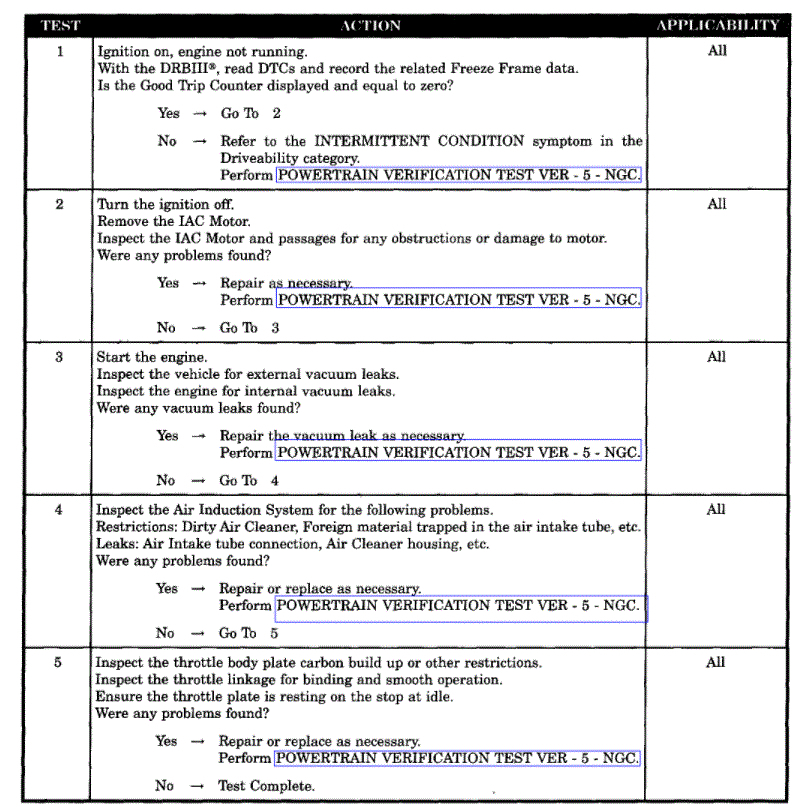

Next, the idle air control performance is related to the high idle. The IAC valve is responsible for maintaining engine idle speed.
I attached the diagnostics for the P0519 below. Let me know if it is something you are comfortable trying. Also, please feel free to let me know if you have questions or need help with something.
Also, here is a link that explains how to service an IAC:
https://www.2carpros.com/articles/idle-air-control-valve-service

I'm not sure I understand what you mean by good trip counter, but when I change the fuel injector I had to take the plenum off. so do you think maybe the plenum gaskets are the root cause for my high idle? As for the EVAP system I can't do a smoke test right now, but when I went to fill the tank at the gas station the neck going to the tank filled so fast that the gas pump shut-off. I'm not sure that would be related to the small leak but it doesn't hurt to ask.
